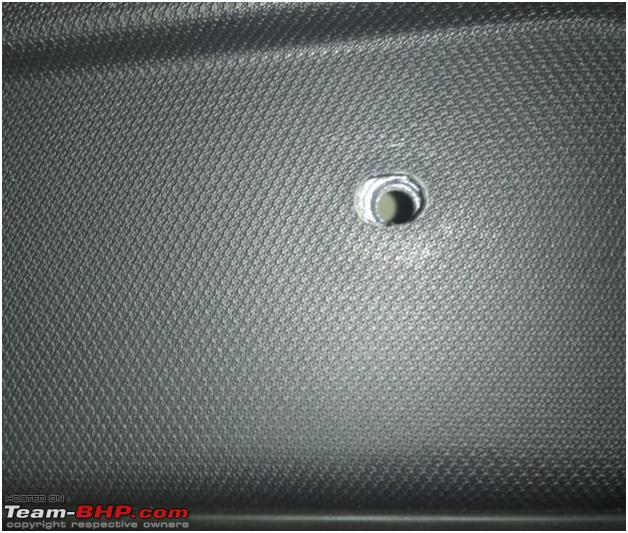

Tried removing one of the plastic buttons to check if threads are available to install the grab handle and this is what I could see. Positive signal to move forward with the next steps.

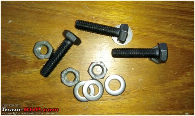

These are 6 mm bolts that come with metal washers and since these washers are too big they won’t go inside the grab handle bolt slot. Also, the washer is fixed on the bolt and cannot be removed. Another issue was that no spanner can be used to tighten the bolt since the grab handle bolt slot is very narrow. From the local market, I could find a similar bolt with a smaller size washer, but the overall length of the bolt was a little less which was ok.

I was feeling lazy to search again for the right size tightening tool and decided to do some jugaad! Cut the bolt head so that I can use a flat screwdriver to tighten the bolt. I did not have a workbench too so used a player. (Try this at your own risk)
