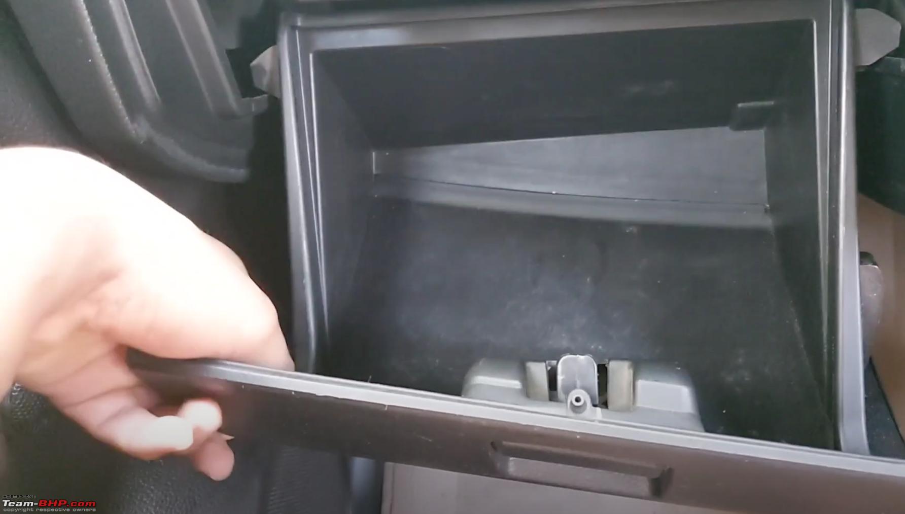

1. Open your glove box and take out everything from it. AC filter of most car is accessible through the glove box just like Wagon R.
2. Hold the glovebox from one side and push it to the other sire to open it a little. Do this on the other side as well and the glovebox will be out.
DIY: Replace / Clean AC Filter without any tool-bhp-glove-box.png

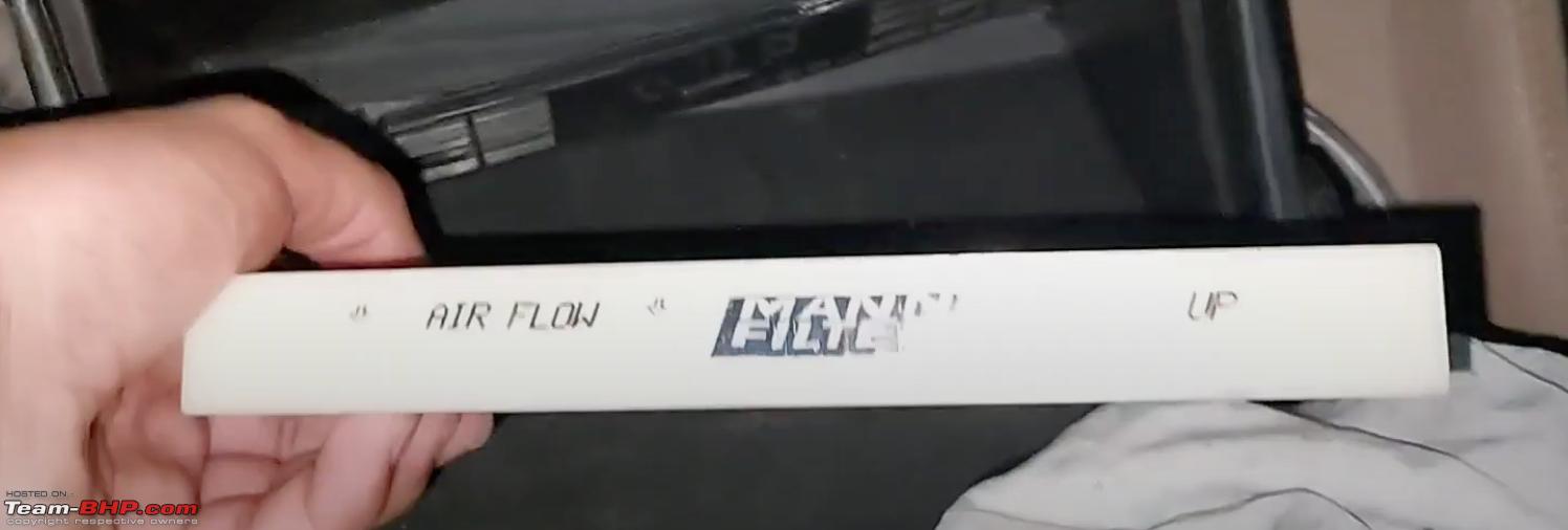

4. Now, you just need to take out the filter and clean or replace it according to your wish. (Note: To put the filter back in the correct direction is very important. The filter has airflow direction mentioned on it to help you in this. Or you can just use the "UP" symbol on the filter.)
DIY: Replace / Clean AC Filter without any tool-bhp-filter-flow.png
