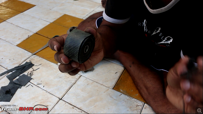

Cut the rubber tube into a rectangular shape. Then wash the roller and piece of tube. Dry it properly and then cut it again into smaller shapes.
My roller had 2 grooves, so I needed to cut 2 smaller strips of rubber to fill that groove.
If you haven't used super glue before, just remember, it is really sticky and you can glue your fingers together and get yourself into trouble and might need to see a doctor. So be very careful with it.
Apply Superglue on the groove and then paste the rubber strip over it.

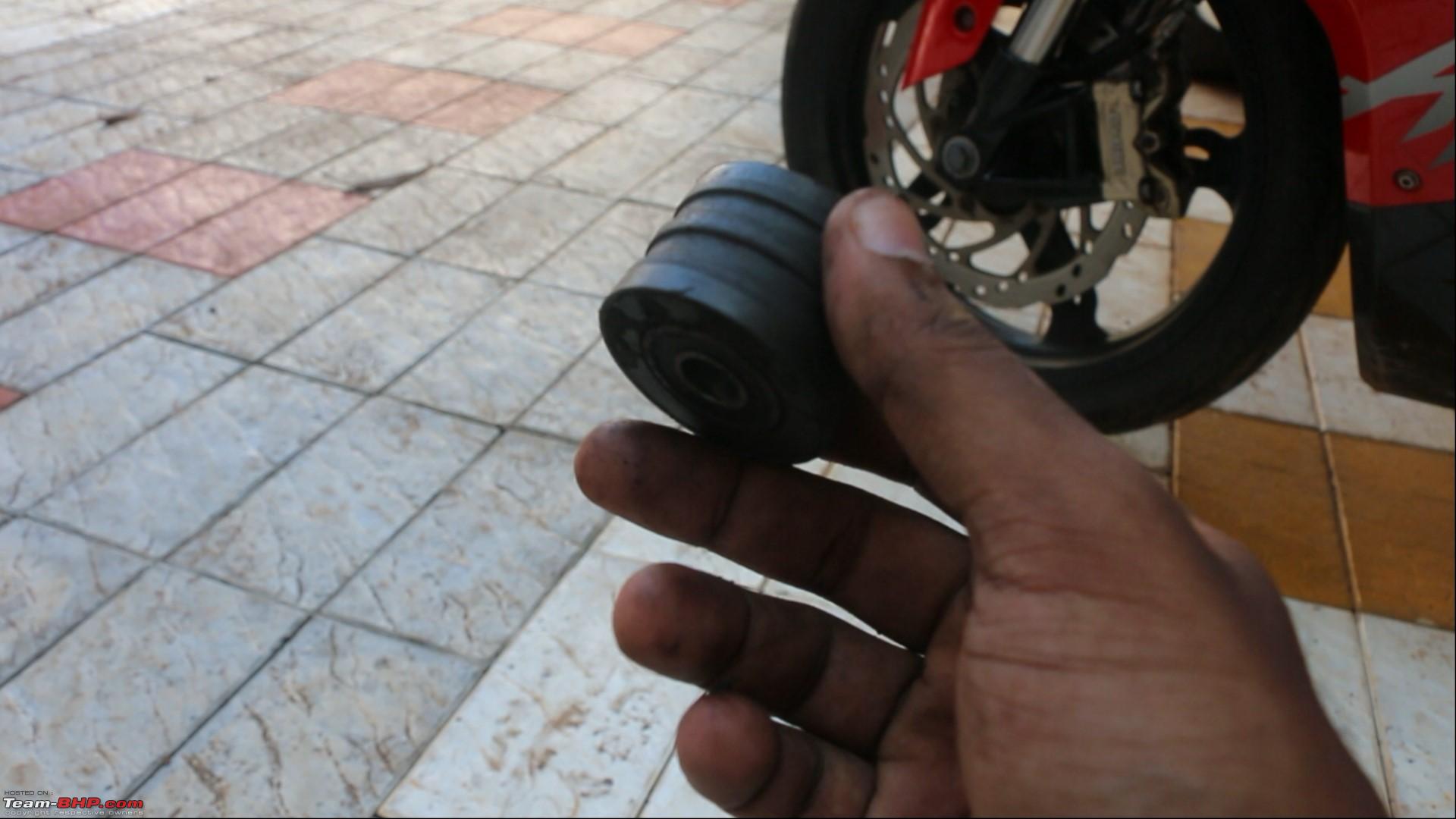

STEP 3 : Apply 2 more layers of the rubber strip over the roller with the help of Super Glue.
This is how the roller will finally look like.
