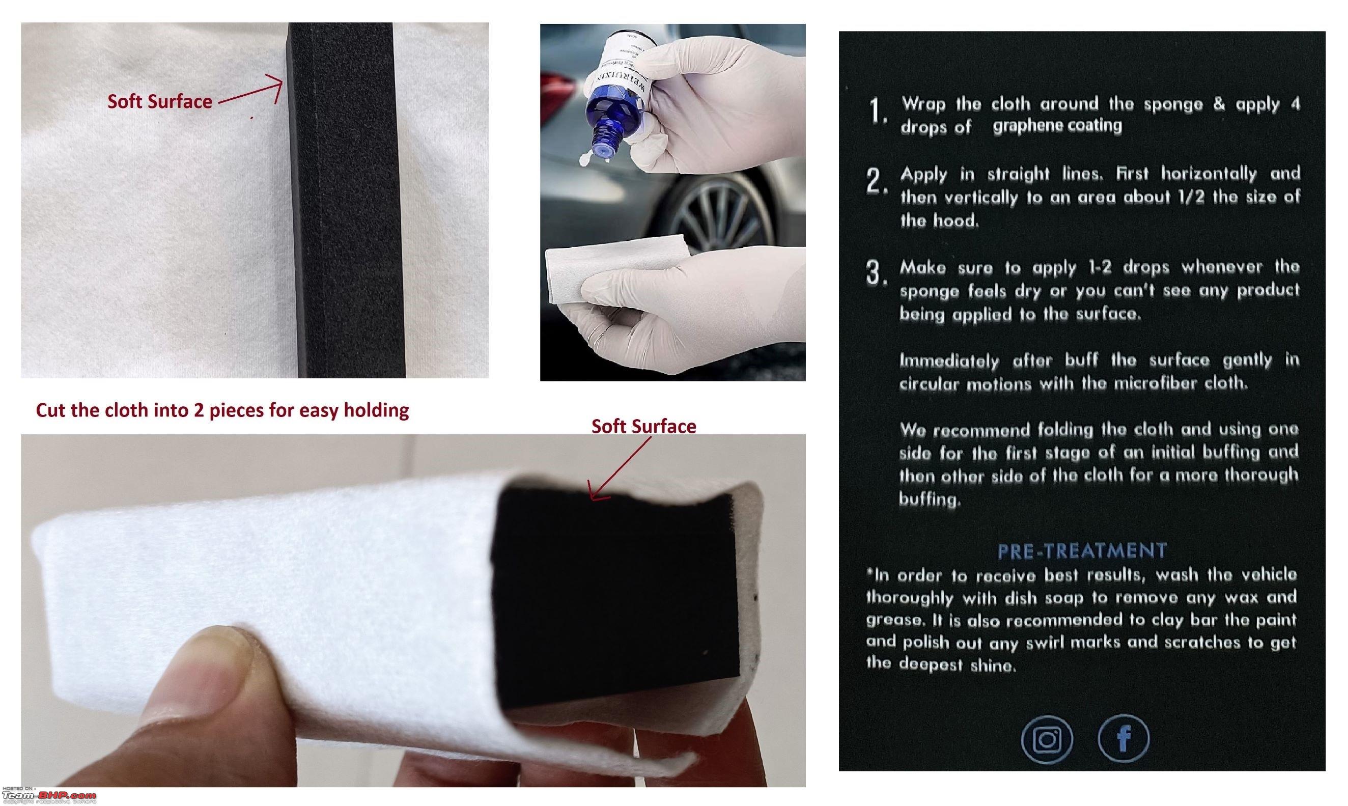

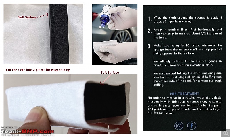

How to apply - Wrap the cloth over coating sponge and put 3-4 drops of coat liquid on the cloth. Starting with hood, spread the liquid on half portion of hood first by applying in straight lines horizontally and then vertically to cover the gaps. Then coat the second half of hood in similar style, meanwhile the first half will get dry (it takes 5min to dry) and buff the coated surface in circular motion using the wiping towel.
Always clean the surface with a dry cloth before applying the coat and change the applicator cloth when it becomes hard.
By repeating the above procedure, I completed coating the whole car including alloy wheels except the roof.
DIY: Applied Ceramic Coating on my brand new car for the first time!-cc-apl_guide.jpg
