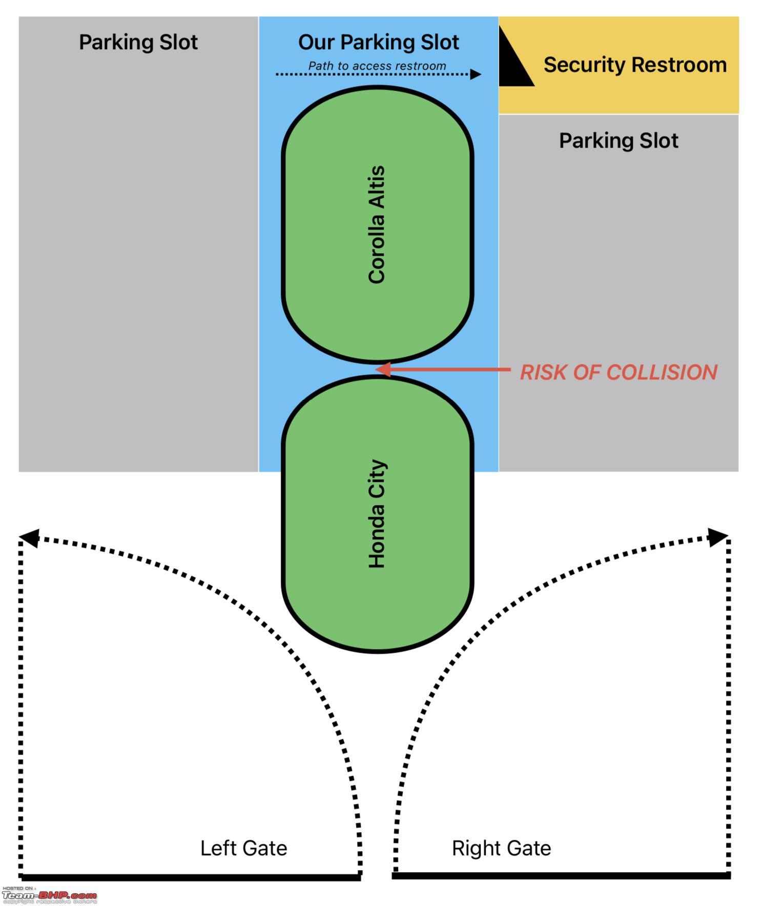

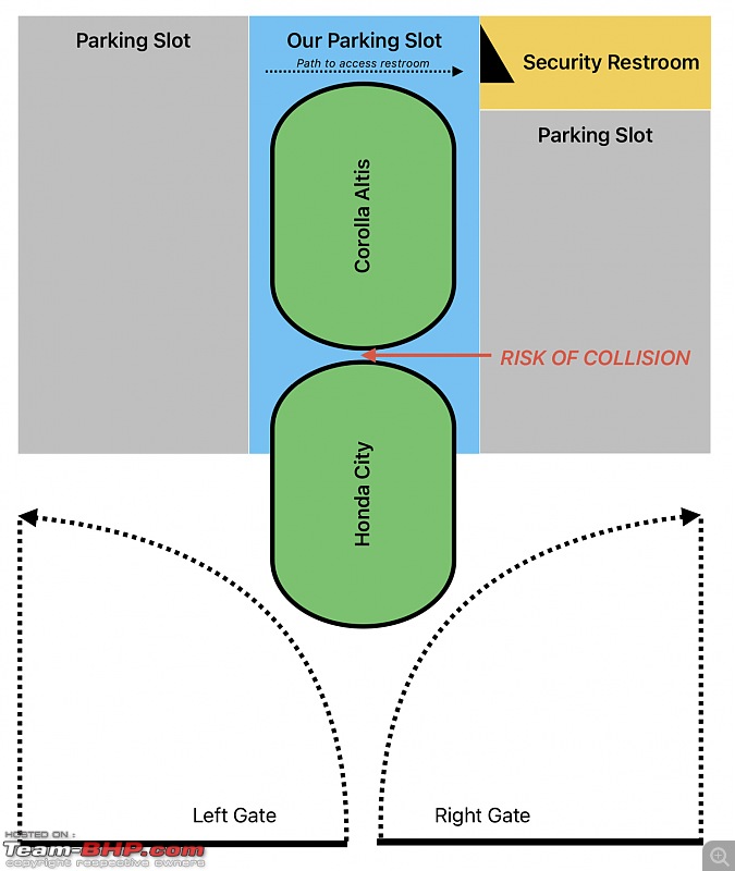

One long slot – tight clearances
What we did have, though, was a long parking slot – although it was designed for only one car, we could fit two cars one behind the other. Whoever comes first parks further forward, whoever comes second parks behind.
Unfortunately, clearances on all sides are very tight. I have tried to express this in the diagram below.

Risk of Collision
Now this leads to a situation where every time the Honda City is brought home, we need to squeeze the cars as close as possible to ensure that the gate closes.
Although we are both experienced drivers, the hoods of both of our cars are not easily visible, and although we should be incident free 99 out of 100 times, the one incident happening where one of us bumps the car in front is going to be an expensive one. The risk is especially higher if one is tired and in a hurry to go home.
Because this is something we do everyday, the probability that we get at least one incident in a year is quite high. Toss a dice a hundred times, you’re almost certain to get a 6 atleast once. The below math shows that even with a 0.5% chance of an accident in one parking event, the chances that we have atleast one accident in a year is 83%.

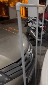

The idea struck from the inspiration that electrical devices are connected via a fuse – a very low tolerance object which gets fried with excess current, blocking further flow – better to fry a 100 rupee object than an expensive electronic appliance connected downstream.

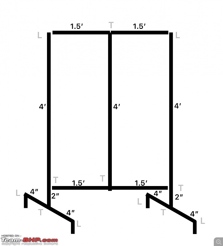

Using PVC pipes, I built a thin lightweight structure – our Parking “Fuse” which could be placed behind the front car. Whoever arrives home first parks, and places the Fuse a few inches behind the front car. Whoever arrives second, drives straight into the Fuse at a slow speed until the fuse shakes.
DIY: A Parking Fuse-img_5310.jpg
DIY: A Parking Fuse-img_5311.jpg
The structure is made using 0.5 inch thick (inner diameter) PVC pipes, with additional L and T joints, attached with PVC sealant. The entire project costed a few hundred rupees, purchased from the first hardware shop I walked into. I could have used some fancy, less easily available joints to make the design simpler, but stuck to using T and L joints which were the only ones the good fellow had. I used smaller pipe sections to make the stand.
DIY: A Parking Fuse-img_5312.jpg
DIY: A Parking Fuse-img_5313.jpg
The width is approximately 3 feet, and the height is approximately 4 feet (to allow easy visibility above the hood and the increased height makes it sway more when bumped). The critical part is the vertical pipe in the middle – because the middle of the front grille is the first to touch (all cars have a curved front grille).
DIY: A Parking Fuse-img_0296.jpeg
With the slightest contact between the incoming car and the fuse, the fuse shakes violently, and is easily visible to the driver of the incoming car – this is when you know you need to stop.

Built using ultra light and flimsy PVC pipes, even if the fuse shakes and hits the car in front, it causes no damage.
With this, parking into our slot for both cars became effortless and de-risked, while ensuring a precise and small gap between both cars, every time we park, consistently.

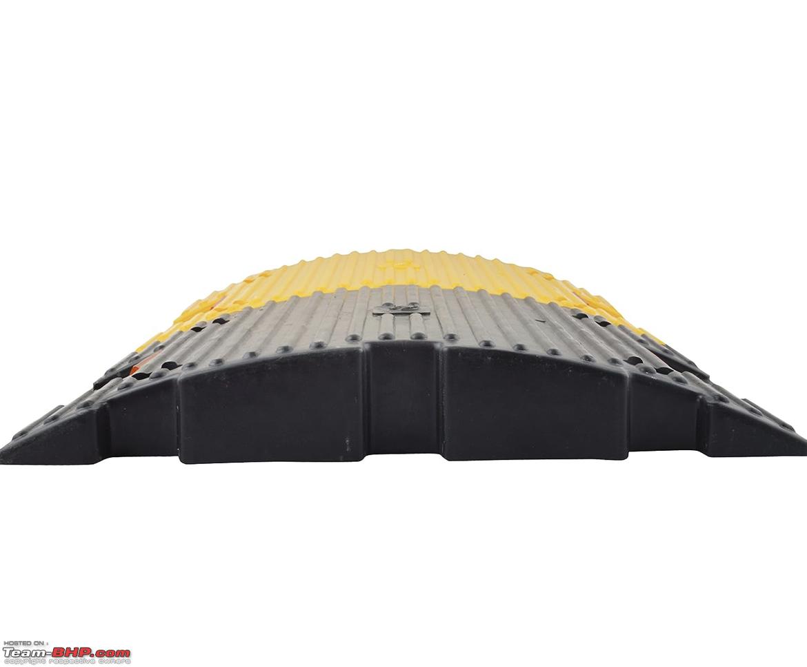

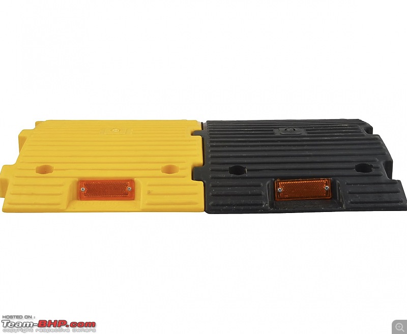

Nice “out of the box” thinking type DIY.
However, if I would have been in your situation, I would have installed/anchored a plastic speed breaker, at the extreme max location where you needed the second car to come to a standstill position (as tight clearance as you want), definitely after marking the extreme point.
Would have saved you the daily effort of putting the “fuse” in-situ. Also there won’t be any infraction or physical touch with the PVC pipes. Something like this.

Nice thinking. Am assuming the clearance needed is even lower than what is allowed by parking sensors and hence the need for this.
What about breeze though? Wouldn't that result in the pipes shaking?
This would work only if the cars are identical or have fixed positions
Hey, thanks for sharing! Yes, evaluated this, but we are not sure which car is behind, also there's a risk of collision if the car in front is parked wrongly (not forward enough), and moreover we don't have permission to drill the tiles.
Overall seemed much more expensive and still left room for judgement error, did not fit our use case.
Still, other readers may find it is a fantastic idea for other situations, like say, one car and a wall.
There is no effort to place the fuse - you can lift the entire frame with a finger. We just keep it on the side and move it to place after removing our bags from the boot.
