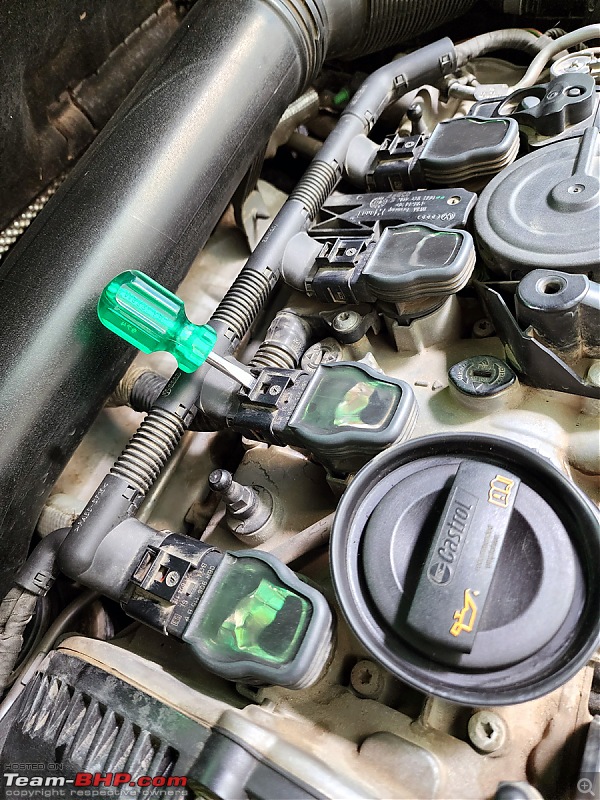

Next disconnect the connectors at the back of each coil pack. Their locks are released by gently pressing the lock tabs as shown in the picture. I did it by hand -
DIY: Changing the spark plugs on my Skoda Superb - A comprehensive guide-skoda-superb-spark-plugs-changed-40505km-17042024_5.jpg
After releasing the tabs you just gently slide them back as shown in the picture -

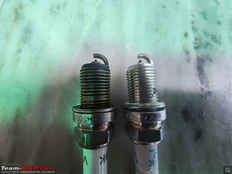

Here's the original Skoda/VW part# in case anyone is interested - 06H905601A -
DIY: Changing the spark plugs on my Skoda Superb - A comprehensive guide-skoda-superb-spark-plugs-changed-40505km-17042024_15.jpg
The old and the new together -
DIY: Changing the spark plugs on my Skoda Superb - A comprehensive guide-skoda-superb-spark-plugs-changed-40505km-17042024_16.jpg
A closer look -
DIY: Changing the spark plugs on my Skoda Superb - A comprehensive guide-skoda-superb-spark-plugs-changed-40505km-17042024_17.jpg

Out came my trusty old WD-40 Contact Cleaner. This is an IPA based cleaner very similar to a Brake Cleaner. I used it to properly clean and store the old spark plugs for any emergency use, as they were still good enough -
DIY: Changing the spark plugs on my Skoda Superb - A comprehensive guide-skoda-superb-spark-plugs-changed-40505km-17042024_20.jpg
Note the difference between the uncleaned one on the left and the cleaned old spark plug on the right -
