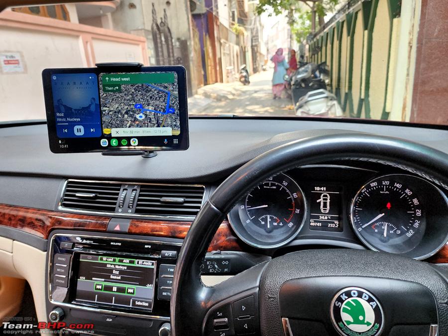

Started from home at 10.41am at 34 degree -
DIY: Get Android Auto in any Car/Bike for Free (or under 10k)-skoda-superb-tab-testing-44-degrees-220520241.jpg
38 degrees at the Expressway. Zero visibility issues -
DIY: Get Android Auto in any Car/Bike for Free (or under 10k)-skoda-superb-tab-testing-44-degrees-220520242.jpg

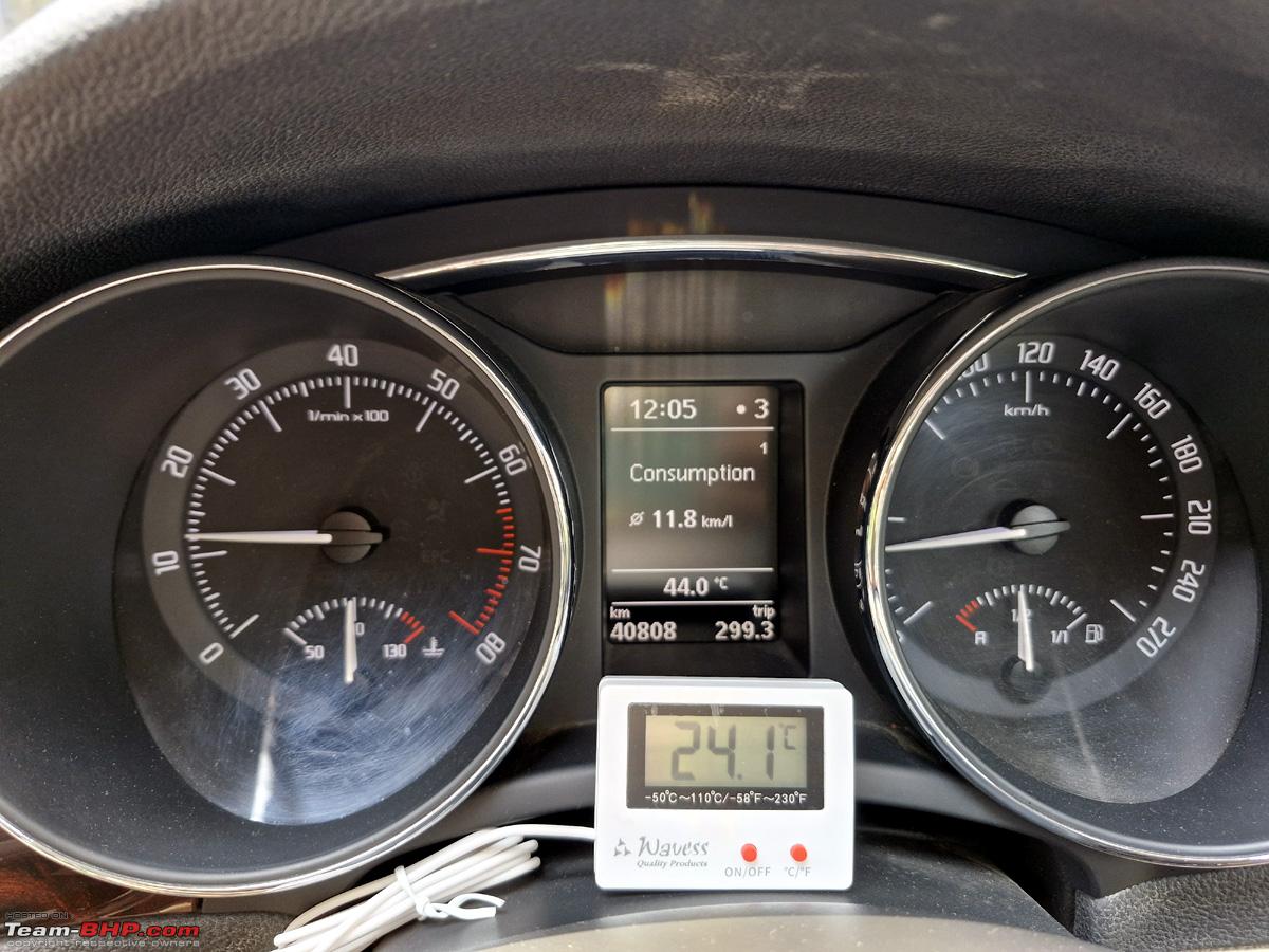

Finally by 12 noon, the temperature reached 44 degrees. The car was chilling 24.1 degrees (Auto AC set at 24). Nice fuel efficiency of 11.8kmpl on this trip -
DIY: Get Android Auto in any Car/Bike for Free (or under 10k)-skoda-superb-tab-testing-44-degrees-220520243.jpg
Tab and Android Auto worked flawlessly with zero lags -

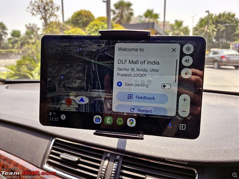

Finally reached our destination at Noida -
DIY: Get Android Auto in any Car/Bike for Free (or under 10k)-skoda-superb-tab-testing-44-degrees-220520245.jpg

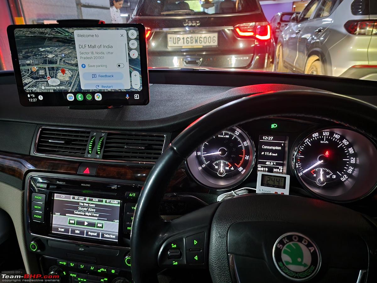

Safely parked in the underground parking. Left the Tab as it is, no power off -
DIY: Get Android Auto in any Car/Bike for Free (or under 10k)-skoda-superb-tab-testing-44-degrees-220520246.jpg

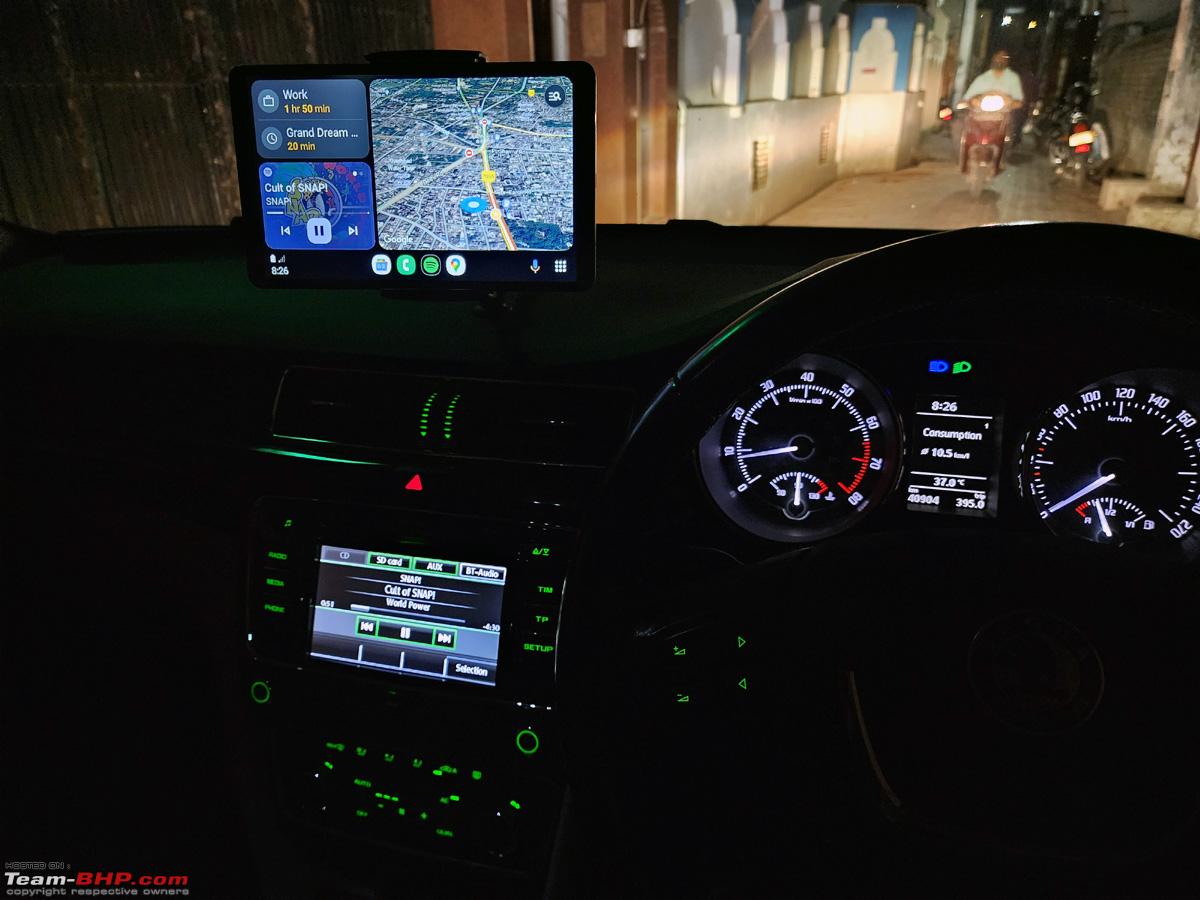

Started back home around 6.30pm. Temperature still hovering in high 40's in this long rush hour traffic. Car was chilling at 25~26 degrees with music blaring through Spotify on the car's stereo -
DIY: Get Android Auto in any Car/Bike for Free (or under 10k)-skoda-superb-tab-testing-44-degrees-220520249.jpg
Finally reached home around 8.30pm hearing the 'Cult of Snap'. Ambient Temperature still at 37 degrees. Return FE was 10.5kmpl due to heavy traffic -
