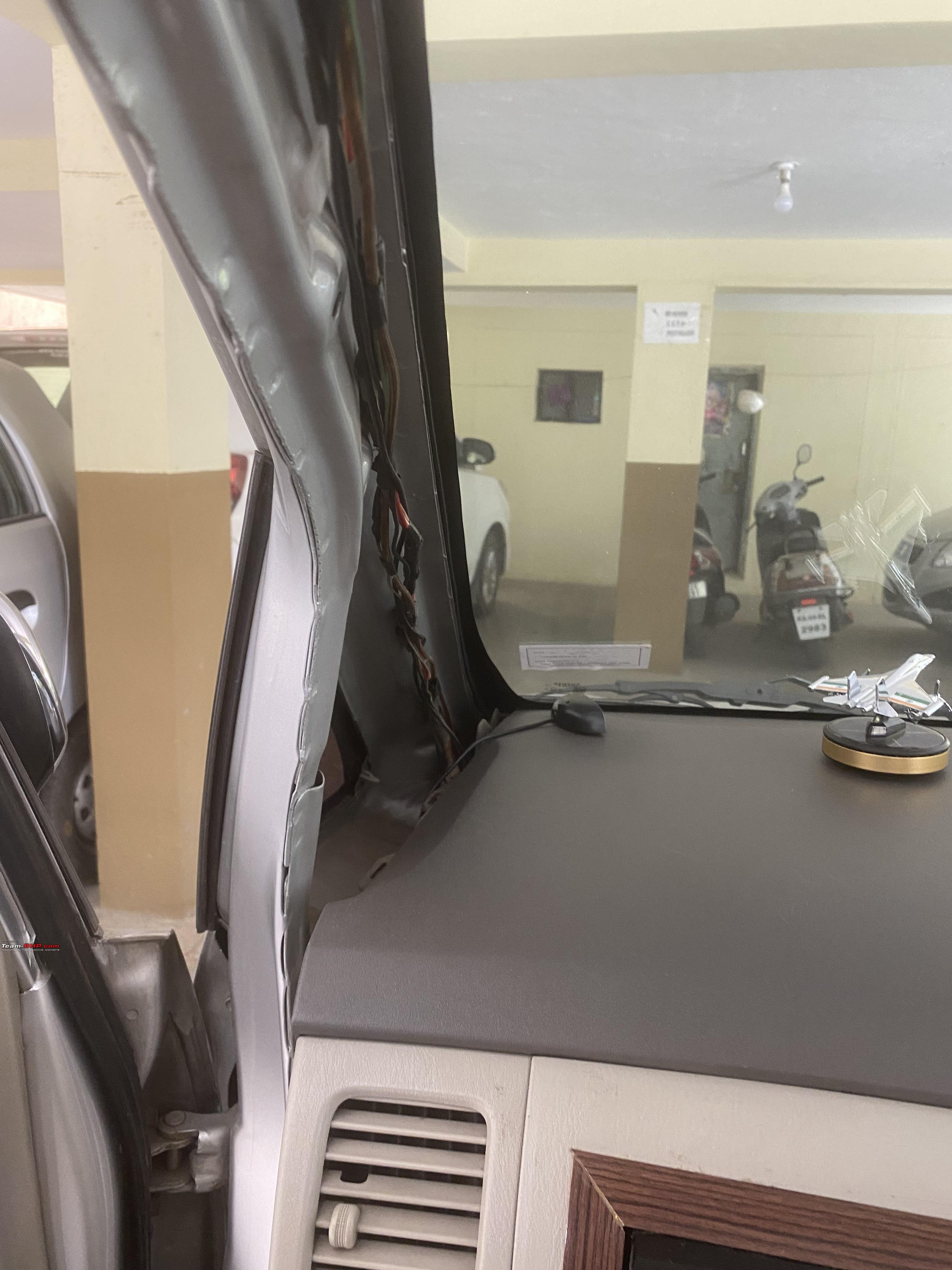

So, the most risk-free route for the wire to reach the rear was on the floor (under the scuff plates) along with all the other wires and rear washer hose. I saw many videos which route the wire through the beading above the door. But I decided to keep it on the floor just so that it will have the good company of other OEM wires.
Considering the length of the power cable, the best position at which the controller could be placed was in the LH Quarter trim toolbox. So, I had to bring the display connector from the rear door into the quarter trim and out from the toolbox cover. It was impossible to pass the flimsy wire through the rear door and make it reach the toolbox. I considered passing a spring wire through the toolbox and pulling it inside like how they do for home wiring but then thought it would be an overkill. So, with a deep breath I pulled hard and unlocked the quarter trim from the top near the quarter glass and quickly passed the wire over from the top and released the trim back. I made sure the wire was free moving inside the trim by wobbling the connector end and making sure the other end was responding with a similar wobble.

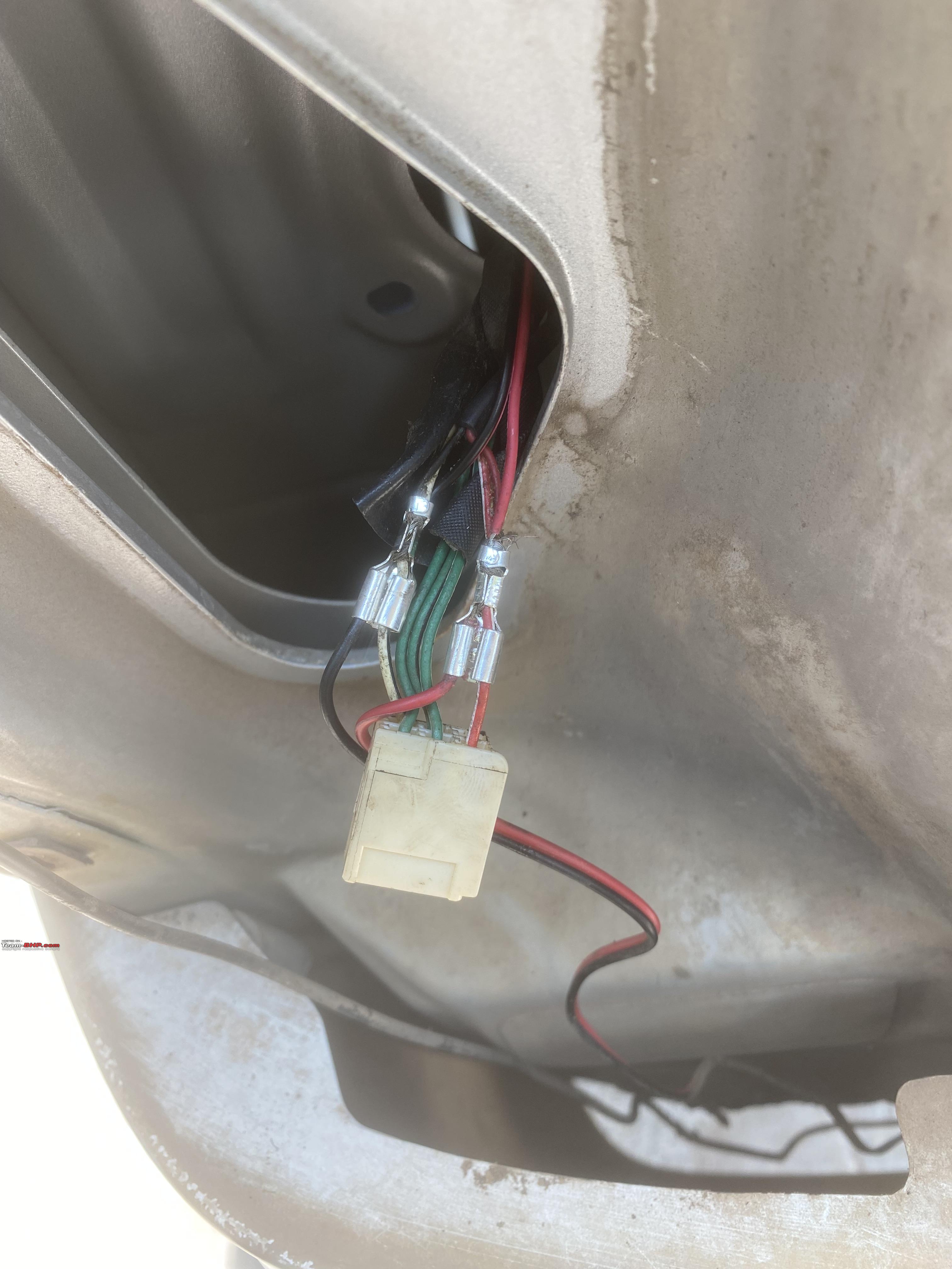

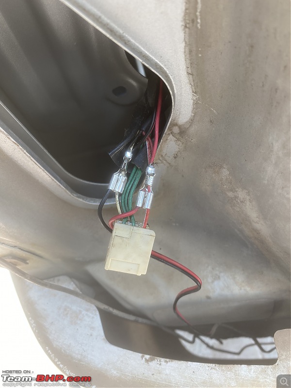

I had not planned for professional wire taps and hence decided to repurpose a couple of spade connectors for the tapping into the wires. I spliced the OEM wires with a heavy heart and twisted skinned power wire of the controller on it and crimped everything as neatly as I could using the spade connector.
Did the same for both wires and taped everything up.
Crimped joints
Final look after taping

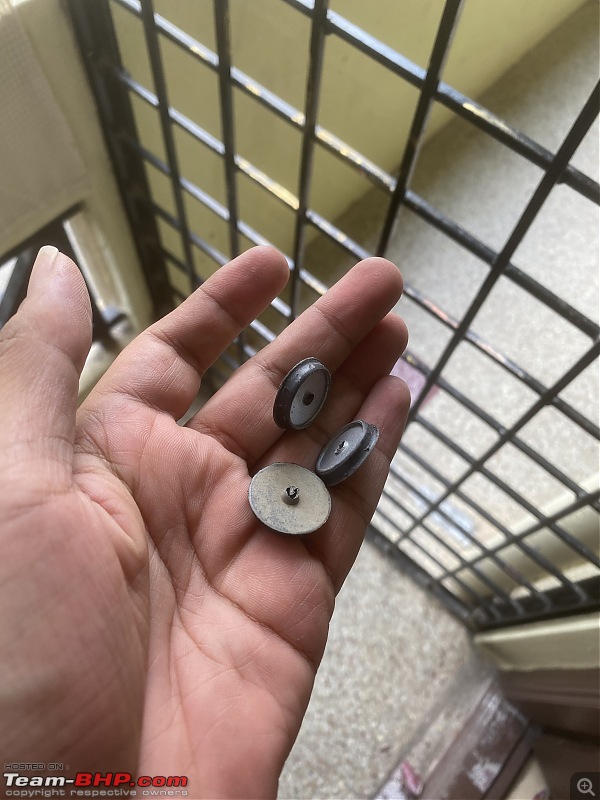

The cut out pieces. Gives an idea of bumper thickness

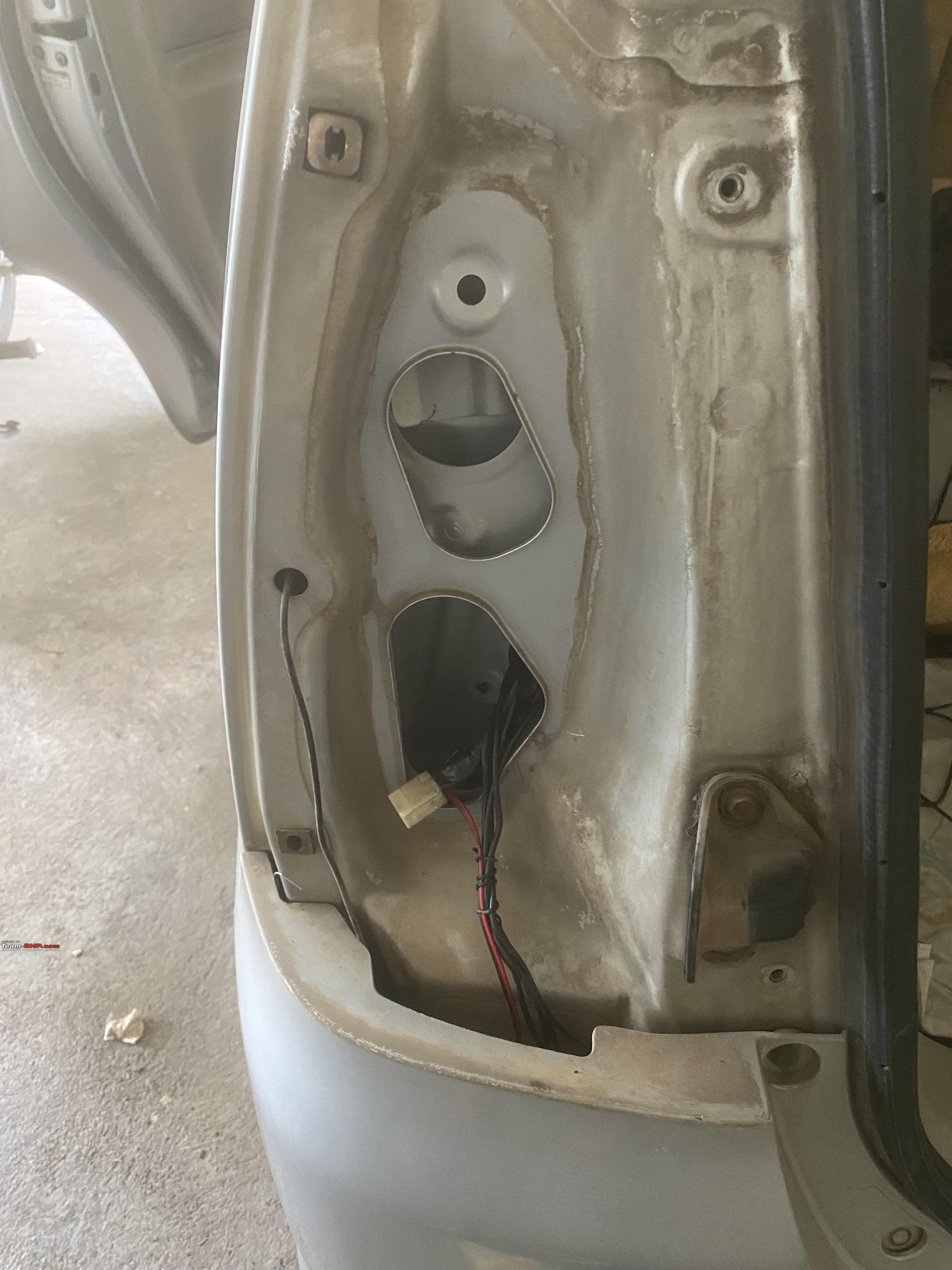

I used those tiny black wire-like things which were used to tie up the wires of the kit to in turn tie the wires in place after installation too. I used it at multiple points throughout the length to keep the wires from dangling outside. I put back the tail lamp after scraping off the rust from one of the guide pins.
A lot of wires into the tail lamp hole
