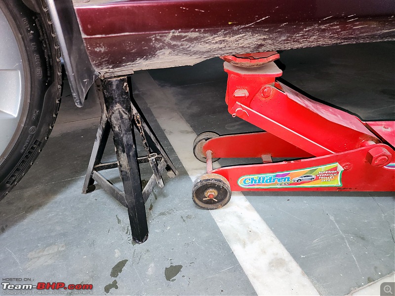

The car was jacked up to remove the front left wheel -
DIY - ABS Sensor Replacement (on any car)-skoda-superb-abs-esc-error-20112024_2.jpg
And properly 'double secured' before proceeding -
DIY - ABS Sensor Replacement (on any car)-skoda-superb-abs-esc-error-20112024_3.jpg

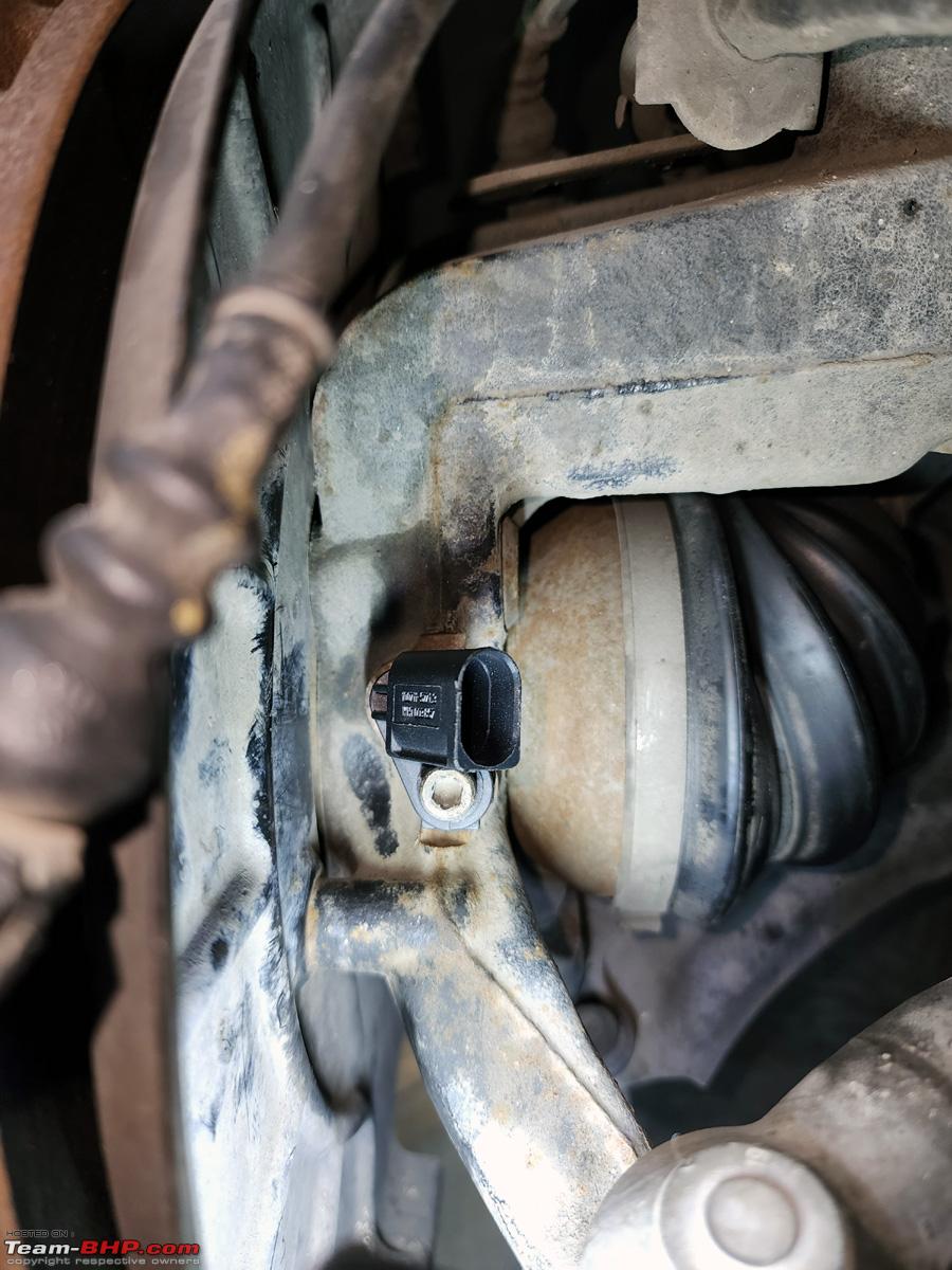

Here's a view of the culprit ABS sensor secured by just a T30 bolt -
DIY - ABS Sensor Replacement (on any car)-skoda-superb-abs-esc-error-20112024_5.jpg
I couldn't detach the top connector as it was too tightly attached. So I decided to remove the T30 screw directly with the connector attached and tackle the removal of the connector with the ABS sensor dislodged (which worked out more convenient). Here's the ABS sensor. When I removed it, it also had a long line a dust at the tip (not visible in the photo as I had cleaned it by then) which in fact could be contributing to the magnetic sensor not relaying the information correctly and the sensor might just be working perfectly -

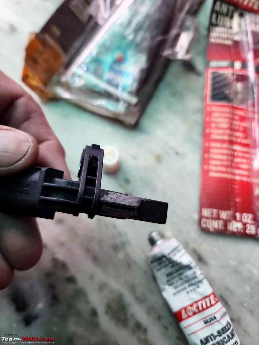

Also came out my handy anti-seize lubricant and Di-electric grease -
DIY - ABS Sensor Replacement (on any car)-skoda-superb-abs-esc-error-20112024_19.jpg
The anti-seize was applied on just the grooved part of the abs sensor while avoiding the tip as stated in Skoda's workshop manual -
DIY - ABS Sensor Replacement (on any car)-skoda-superb-abs-esc-error-20112024_20.jpg

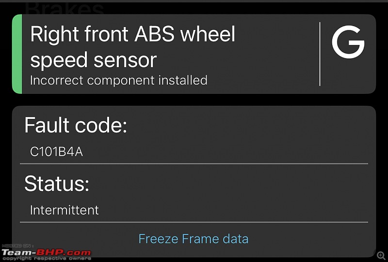

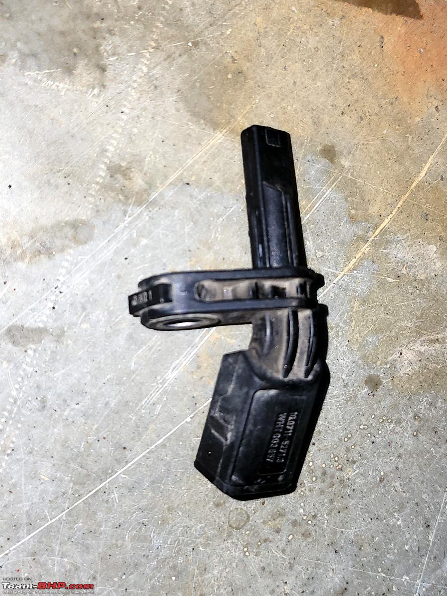

Thank you so much for posting this, was facing the same issue in my 2018 skoda Octavia. Steering got unnecessarily hard at low speeds, park assists (sensor/camera) stopped working, along with some other things.
DIY - ABS Sensor Replacement (on any car)-e48613ec199943fcbf88cc184e529623.jpeg
Ordered one from skoda but labour was quite expensive. But then I stumbled upon this thread. Me and my friend fixed it yesterday. It was a 30-40 minute job!
