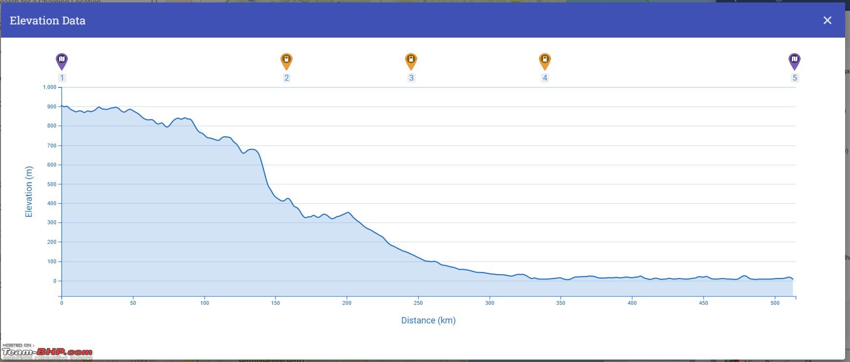

Elevation changes are chalked out below by the website and we can see that Bangalore is at an altitude of almost 900 meters from sea level and Ongole at almost sea level. So going to Ongole will be less demanding on battery than coming back to Bangalore.
