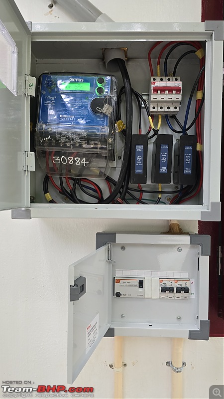

On checking with KSEB, they asked me to install all the necessary equipment and then apply for the connection. Our electrician took some time to come but as usual, did a very good job. The cost of the equipment and his services came to approximately Rs.15k.
The things specifically needed were:
1) 3 phase connection
2)Service wire – 16 Sq mm Aluminium (If you use the usual 10 Sq mm Copper cable, there is a risk of fire while using the 7.2 Kw charger)
3)HRC 63A fuses (Avoid the 32A Porcelain fuses, again due to risk of fire)
4) 10 Sq mm Copper wires to connect the Fuses to the Energy Meter
5)Adequate earthing (10 Sq mm Copper Earthing Cable)
These upgrades were required in view of the 7.2 Kw AC Fast charger. Since there would be 2 EVs in our garage, a 7.2 Kw charger makes sense (Our house already had it). If you are not planning to install the Fast charger, items 2 & 3 are not necessary. But if you do it the proper way, you are future proofing your charging infrastructure and can avoid hassles later on.
After completing the instillation, my electrician gave me the necessary paper work. (He was also preparing the documents for an EV Charging connection for the first time). I submitted it at the KSEB office and paid a fee of Rs.60. I got a SMS saying that Inspection will be completed within one week.
Nothing happened in the next week. Followed it up with the office. They finally did inspection after 9 days. After another 4 days, they sanctioned the connection. The connected load was 8.5 kw (It included the 7.2 Kw AC Fast Charger and the 16A charging plug).
I paid a total amount of Rs.14,478 at the office (Cash. Still no POS machine/UPI facility). The KSEB Officials came after 6 days and completed the installation process.

Post installation, I got a SMS saying that my connection process is complete. My connection was categorised as LT – 10 (the usual 3 phase domestic connection is LT-1/three). I searched ‘LT – 10’ online and finally managed to get the details regarding domestic connection for EV Charging, which I have given below.

2)Service wire – 16 Sq mm Aluminium(If you use the usual 10 Sq mm Copper cable, there is a risk of fire while using the 7.2 Kw charger)
Congratulations on the BYD.
Could you share the cost/meter for this? Is this 4 core (3 phase + neutral)?
Also have you considered a freestanding charger setup (like the one's you see in charging stations) with cables routed through the ground? Would need some amount of civil work, but wouldn't that be convenient in the long run?
thomahawk is offline   (2) Thanks
Hi.
Thank you.Yes, waiting for the BYD.
It is a 2 core cable.The cost comes to Rs.80/metre.
I needed to buy 55m, hence the total cost was Rs.4400. The length depends on the distance of the electric post to your supply mains. The KSEB guys will measure it and tell you.
Icould have gone for a freestanding charger.
But the 7.2 kw charger was already installed at our home and its position was at an ideal location.
Hence did not change anything.
- Cost. 30k is not a small amount.
Thank you for your detailed post. Looking forward to your 2-EV garage pics.
Couple of small things.
Aluminium has a much lower conductivity/ higher resistance than copper. 16 sq mm Aluminium wire has the same current rating as 10sq mm copper wire, for the same temperature! So, there is no additional risk of heat or fire from 10 sq mm copper, if it is actually copper. But with obscenely high copper prices, the Aluminium wire is likely to be cheaper.
The cost of 30K for setting up your own 7KW charger at home.
Look at it another way. What %age is it of the cost of the two EVs: ZS EV and Atto3?
At that small an incremental cost, you have a personal fuelling station at home. No need to wait in line at a petrol pump. We pay much more for car features that add much less convenience than a 7KW home charger. Increasingly, the L2 AC chargers in 7-11KW range need to become common at homes and offices.
It will be great if we can gradually mandate new chargers to be bi-directional. So, they can provide electricity to the home in case of a power cut or a natural disaster, or use energy stored from your own solar panels. It'll be ultra useful to soak up excess solar production during the the day and use it to power the grid in the evenings. I feel our govt babus are short-sighted. A little bit of incentive for EVs with V2G capability can make people buy these 'batteries-on-wheels' with their own money, reducing the need for the electrical grid to invest additional money in large grid batteries.
Hi
The 16G Aluminium wire is recommended by the company which installs the chargers. Even if theorotically the risk of fires is low, it has happened in my colleague's home. Better safe than sorry. Also , it can be considered a firmware update to the house's electrical circuit.
30k is not a huge amount if you consider the lifespan of 2 electric cars. Its an amount you will definitely get back multiple times over the course of 4-5 years.
As for bidirectional chargers, we are still not ready for it. But it will happen. The EV industry is growing fast.
