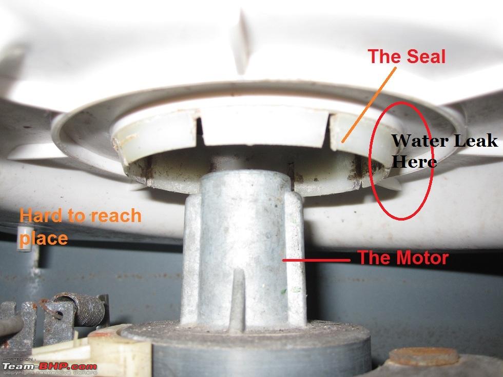

Turns out that the seal has a slow leak that's dripping water on the motor making it go crazy. That explains why it ran when it was dry. The actual seal is OK but it's leaking where it grips the chassis of the washing machine.
Can someone please suggest a good water-proof rubber-plastic adhesive (cum filler) that I can use to plug the gap?
We already replaced the seal and motor a couple of years ago so a bit reluctant to go down the same path so soon.
Please get the seal changed ASAP. Running the WM with water dripping on motor is very very risky. I had a Samsung WM that started giving mild shock while running. On checking the seal on the dryer motor was found defective. That was changed but after a year or so the problem recurred. But by we had decided to get fully automatic WM so disposed off the old WM.

The seal's good. The gap between the seal and the chassis which was filled with some cheap adhesive by the repairman last time has become brittle. Filling that up should suffice I feel - if that doesn't work I'll replace the seal.
Any silicone based sealant may work nicely. Silicones age well, and are excellent sealants.These are often used to seal around things like bathtubs. See if you can source small quantities or go to your friendly body shop /plumber and get the fag end of tube. Even PU can be used but that tends to harden a bit too much.

Is a rubber based adhesive such as the Anabond 87X (871,870, etc) series also make sense?
I'll try if I can find Silicone sealant, else I'll have to settle for something else.
I could even suggest Fevibond (Latex based) but that is not in the same class.

An update to the washing machine leak issue.
I looked for Silicone Sealants but found something else for cheaper and equally promising.
I opened the tub up and sealed around the rubber seal (after cleaning it well) using "MSeal SealIT". This sealant comes in small tubes of Rs.50 but it doesn't mention what its based on - the sealant upon drying resembles soft white rubber more or less.
I'll let you know how it holds up after a few days of use.
