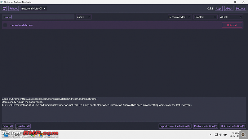

  4. For example, if I want to remove the "Google Chrome" app, I'll just find the package name for Google Chrome in the gui interface and tap on "Uninstall" following which the app would be uninstalled.
    De-Bloating Android Devices | Xiaomi, Realme, Oppo, Vivo, iQOO-screenshot-19.png
    De-Bloating Android Devices | Xiaomi, Realme, Oppo, Vivo, iQOO-app-removed.png
  5. You can also restore any app that you uninstalled by mistake by changing the list from "Enabled to "Uninstalled" and just restore the app that you want.
