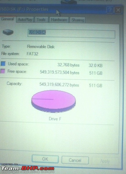

My better half brought this awesome 512Gb Flash Drive from HK. It is just too cool and work fantastically well. Infact i have an external HDD which is 200GB and costing probably 10 times more. Now that seems totally useless.
Although its a fake copy of Sony Vaio, but what the heck. As far as it works fine it, that does'nt really matter.
Here are a few pics i clicked this morning:

There used be lots of fakes sold in HK.
Trik is to change the chip so that it reports 512 GB even if size is lesser.
Can you try this verification:
1. Copy 500 GB worth of data into it
2. Compare it with original [fc command will do that]
If it is really a 512 GB drive then it is amazing.

Its a fake drive. its a fat32 formatted. Fat 32 cannot be formatted for larger capacity drives. Its some software trick.
SirAlec is offline

its a fake 512 GB drive.
They show up in your PC as 512Gb, they format to 512, but in reality, any files copied to them after their much lower limit are unusable. Another good indicator is the time required to copy the files, it shows as 60+ minutes to copy, but when the REAL limit is reached, the copying time suddenly drops to seconds and then completes.
anything you put into it after it reaches its actual limit will be unusable !

I have one that I bought from China for Rs. 300. Looks identical but reads 32GB as the capacity. Doesnt work.
The method I used to test it was by copying photos onto the drive and then viewing them in thumbnail mode. Most were corrupted.
