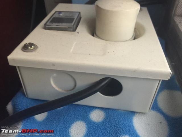

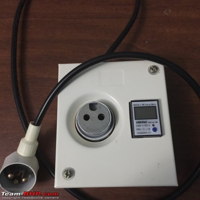

I built this by purchasing the energy meter from aliexpress and the rest here.

Very simple, need a dual pole metal clad plug and socket with cabinet, energy meter and cable. I wanted a sleeve for the power cable to prevent pull on cable but couldn't find that and the cable was too fat for me to be able to knot it. The second image shows the hole through which the cable exits the case and the third is the kind of sleeve I would have liked to get. The other thing I considers was to have two female sockets in this cabinet so that I don't need to take a cable out of the box but then kept it simple to do the job..
