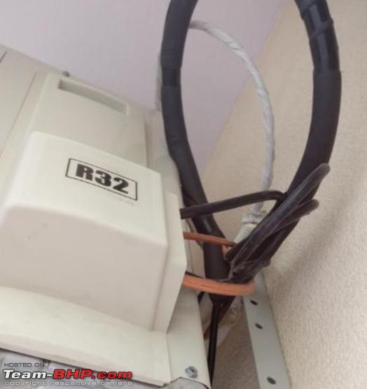

Originally Posted by Aroy (Post 4183675)
That is why, in my opinion, an excellent installation with excellent workmanship is the first thing one should insist on, and that costs a lot of money. We paid upwards of 7K for installation of our Daikin Inverter and the piping is a treat to see even now after 3 years.
After reading your post I checked up the installation done at my place and found 2 pieces of piping totally exposed. Looks like a shoddy job. Do you think this is something I should get fixed right away and ensure its fully insulated ?
Attachment 1630232
Attachment 1630233
You should definitely insulate the exposed pipes ASAP. Apart from increasing the cooling, insulation would prevent electrical shocks in case a frayed bare wire touches them.

You are wasting some energy in "cooling" the outside air.
Pipe insulation is absolutely not supposed to be tightly bound with tape. This reduces its efficiency. It is the air bubbles that insulate: let them not be squashed!
