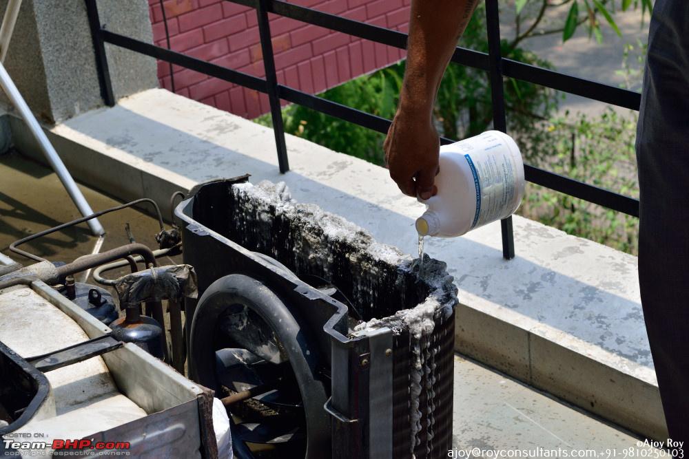

The problem with modern AC condensers is that they are spaced very close to increase thermal efficiency, but in our dusty and pollution laden atmosphere the closely spaced fins soon clog up, reducing efficiency drastically leading to premature failure. Most of the split units have a larger ODU condenser, hence lower rates of failure.
In your case I would suggest that you get hold of an assembler who will assemble a window unit with old spec condensers (basically wider spacing, lower efficiency). In case you can do without electronics, get one which is purely mechanical - thermostat, fan control and louvers. That will last as long till the compressor is worn out.

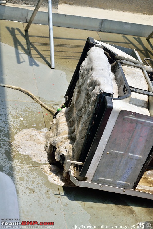

There is a condenser flush used by my AC mechanic. You can try it.
The home / office air-conditioner thread-gsc_2951.jpg
The home / office air-conditioner thread-gsc_2952.jpg
The home / office air-conditioner thread-gsc_2954.jpg
The home / office air-conditioner thread-gsc_2957.jpg
Dilute the chemical as per instruction, pour over the coils and wait for action to begin.
Just ensure that all the chemical is thoroughly washed out
