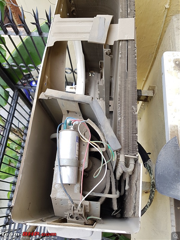

Originally Posted by bluevolt (Post 4249363)
My 1.5 T Voltas Split AC started throwing hot air from its indoor unit yesterday after some 15-20 minutes of operation.
It was chilling well when started but suddenly I noticed warm air coming from indoor unit. I was surprised as there was no burning smell either.
I switched off immediately and removed the main supply.
Before I call technician over weekend, any pointers on why an AC without heat pump can throw hot air suddenly? Compressor failure ?
Originally Posted by Thad E Ginathom (Post 4249423)
If you have just started it, it will take the air from above it and blow it, and it is surprisingly hotter up there by the ceiling. Otherwise, I would just call that technician. Compressor failure or gas leak does not make it blow hot air: just room-temperature air, ie it does nothing except blow.
But you might feel it as relatively warm if it had been cooling before.
Our second-hand mix'n'match stopped cooling a few days ago. It failed back in late May, and our guy did a quick-and-dirty just-charge-the-gas. This time, he found a cracked nut, charged us only for call out and gave the gas for free :)
So I checked the outdoor unit of my AC today. Found the compressor to be running, indoor unit giving chilled air upon starting BUT the outdoor unit fan is not running. Just after few minutes the compressor cuts off, probably due to overheating and I guess the indoor unit is throwing warm air just because of this due to no heat exchange in the out door unit.
Planning to call AC technician next week. I believe this will require replacement of outdoor fan motor or anything else can be culprit?

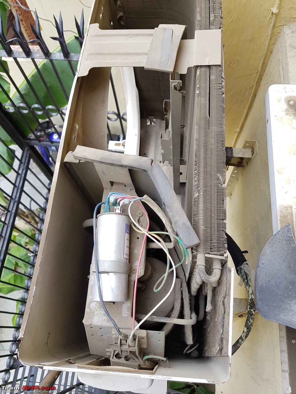

So actually the fan motor of the outdoor unit was the culprit.
Got it replaced with an aftermarket new one for Rs. 1700. The fan has to be replaced as well as the old unit was not compatible with new motor.
The new motor/fan combo is noisy though, but the cooling has improved probably because of the airflow improvement with a new multi blade fan in condenser unit.
