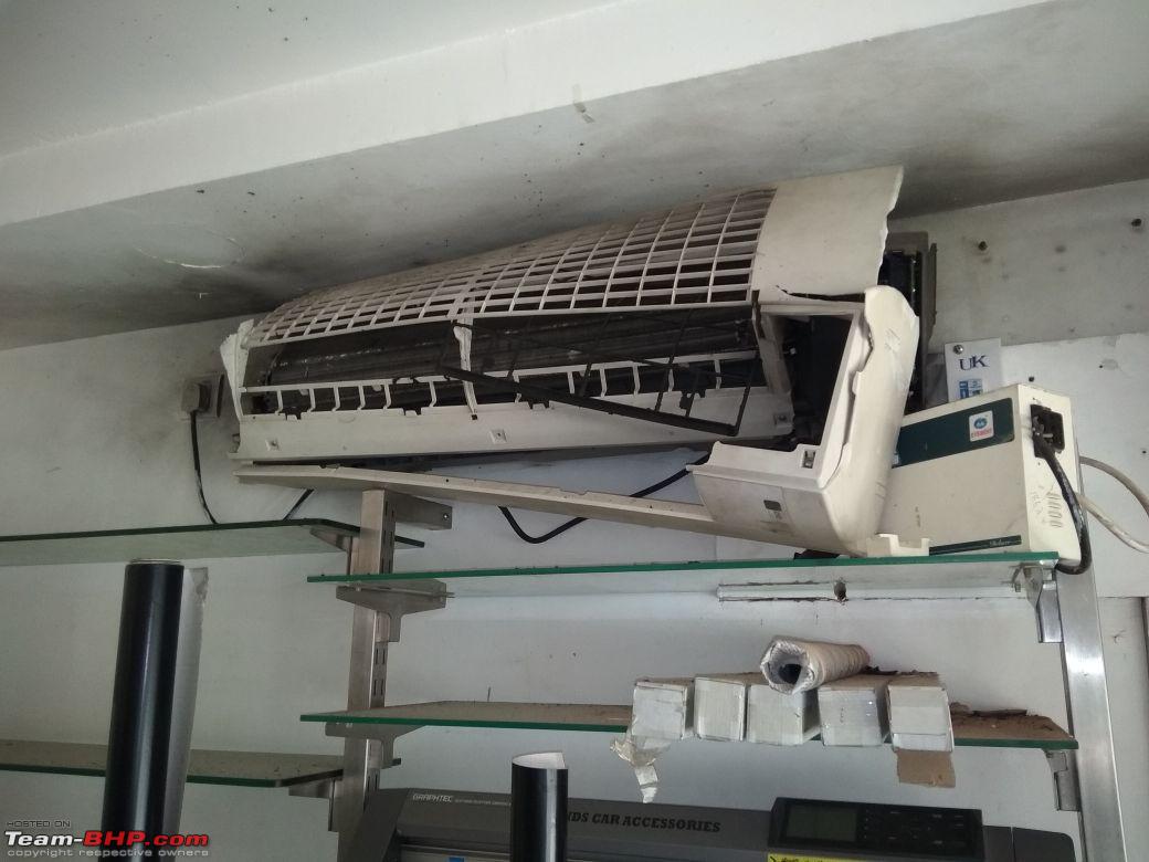

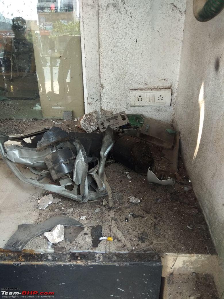

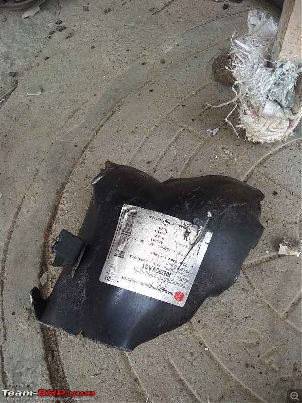

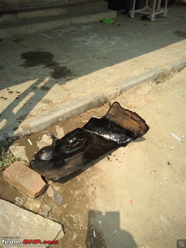

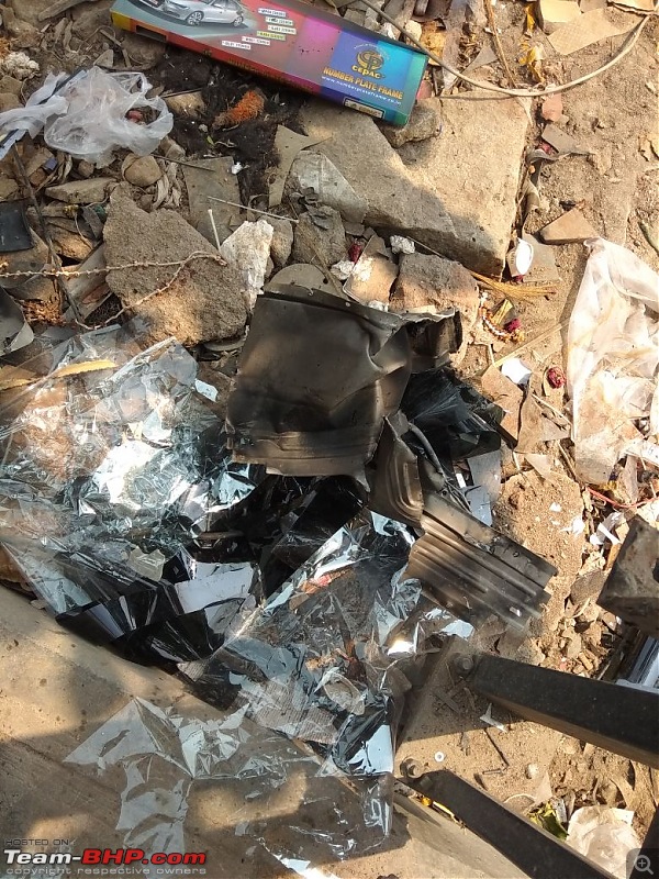

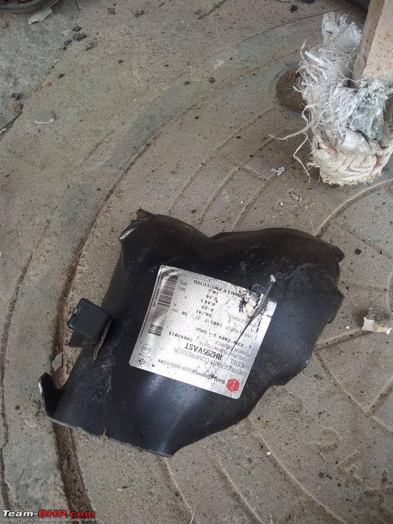

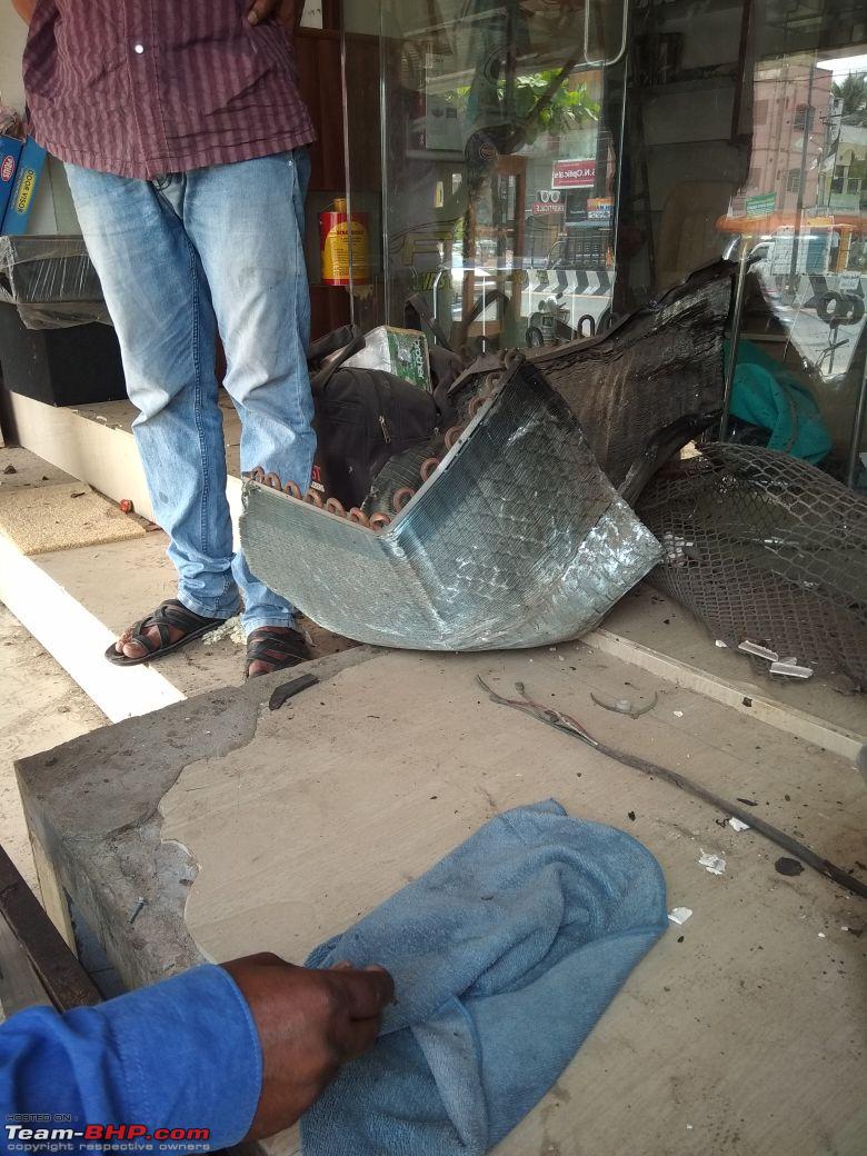

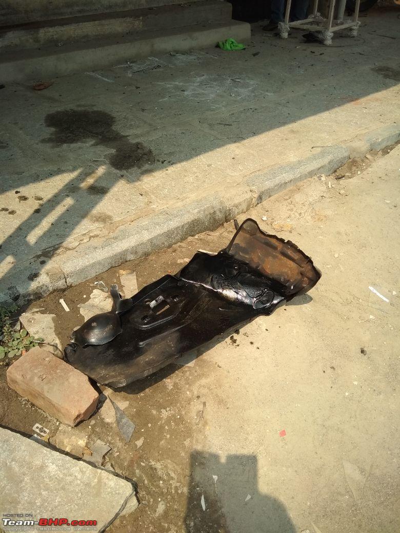

This is a worrying thing. Our engineer (local street guy) has recently seen two cases of new Daikin machines exploding. Serious damage. He put my wife completely off the brand :(.
Why would they happen? Is Daikin still premium... Or dangerous? :eek:
Have photo in WhatsApp. Will post when I go to PC.
Buying a new 1.5T will eliminate the confusion. No swap needed then.
What component in an AC are prone to exploding? Compressor? Does the refrigerent catch fire? Is that something I should be worrying about?
I don\'t think AC will explode, must be some really untrained careless installation was done in those Ac. Daikin in most models use R32 gas which runs on higher pressure and they are pretty much used world over with many industry first.
Exploding AC --- Pictures

Let me just say... :Shockked: !

Seems to be a 2013 model ac from the compressor label. I had a Hitachi window ac blow up but not to this explosion level. The window ac was installed in a room with the outdoor on a balcony. This balcony was subsequently boarded up and as a result of the heat build up, it kind of exploded, room was filled with smoke. From the pictures can't really say what happened but is definitely scary.
From those pictures of compressor, its a older R22 gas compressor. Which these days are not used in any inverter Ac.
It does look scary but that compressor model is used by many other Ac makers.
