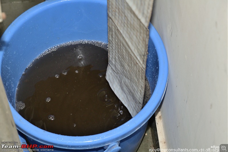

My LG Inverter is three years old. Somehow my bedroom AC's get a lot of dust. This has been a bane for ages with my window AC's getting clogged and requiring a thorough wash at least twice a year.
Coming to the LG split.
First year the dust jammed the condenser. It was a joint effort of dust and high humidity during rains. After inspecting the unit, the technicians decided to dismantle the IDU. They then took to our garden a gave it a thorough wash. You had to see the dirt that came out

So that is deep cleaning. By the way the cleaning after dismantling was way better than in-situ.
If you are wondering about gas, don't. The system just pumps all the gas into ODU, and the proper valves are closed, so practically no gas is wasted.
