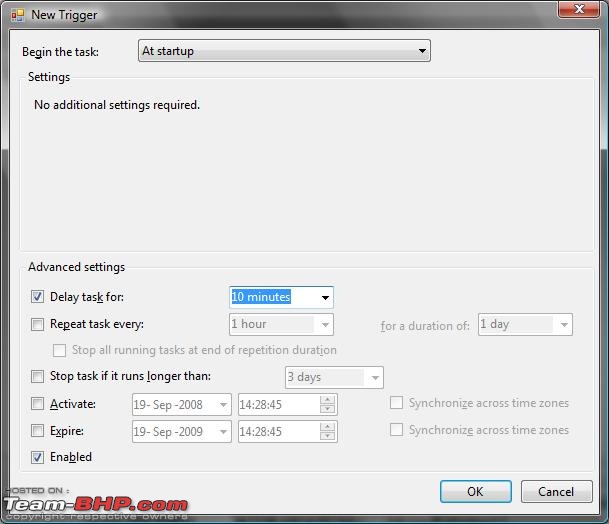

For creating a task in Vista do the following. Go to Start > Programs > Accessories > System Tools > task Scheduler.
Here you can create a task to execute your startup file. You can also set a trigger for it to run at system startup and add a delay of 10 mins. This way your task will execute 10mins after startup. At least this is what I thik the delay feature does. Let me know how it goes. Also ensure that the Activate check box is checked.
Info about the delay feature.
Delay task for or Delay task for up to (random delay): This setting allows you to specify an amount of time to delay the task from running, after the task is triggered. If you are using a time-based trigger (On a schedule), then the delay time will be a random time between the time the task is triggered and the time specified in this setting. If a task is scheduled to be triggered at 1:00 pm, and the Delay task for up to (random delay) setting is set to 5 minutes, then the task will run sometime between 1:00 pm and 1:05 pm.
