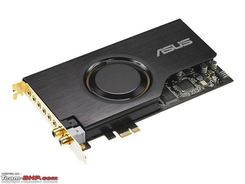

3.5mm to RCA cable for audio, which one?
I am planning to use ASUS D2X sound card in my car.
It has 3.5mm Stereo output plug, so I would need either
A 3.5mm stereo to RCA cable (with 3m cable) - preferable or
A 3.5mm stereo to RCA splitter and a long RCA cable
It needs to be noted that this sound card has the output plugs very close to each other (look at the picture), which means 2 plugs with fat pins cannot be plugged next to each other :(
Please advise that considering my setup (Audison LRx4.300 & LRx1.400 + Hertz HSK165 + Adire Brahma 15" Sealed Sub) which RCA cables should I go for? Currently I am using Scosche RCAs from my HU to amps.
I do not want to unnecessarily splurge on the cables but I hear that at least decent RCAs are a must. so please advice.

I don't use rear fills as of now, but with Carputer coming in, I would be going for 4.1 sound (for movies, etc), so rear fills will be added. Nothing great just some regular stuff for rear. May be later I might move Hertz HSk165 back and get something better for fronts.
But I didn't understand, how will having or not having rear fills change the connections.
Thanks LBM_J, I saw your thread and that is one option I am considering. Just wanted to have few options also to look at
Do you think the regular 3.5mm plugs will fit comfortably on ASUS card, or is there a space constraint to need thin case 3.5mm plugs?
Its based on the cable. MX and Monster wont fit. You may need an extender like icablelink. Dont use MX/Local cables for that. Also make sure, you dont need for all cables, one will fit if the nearest pin is extended.
