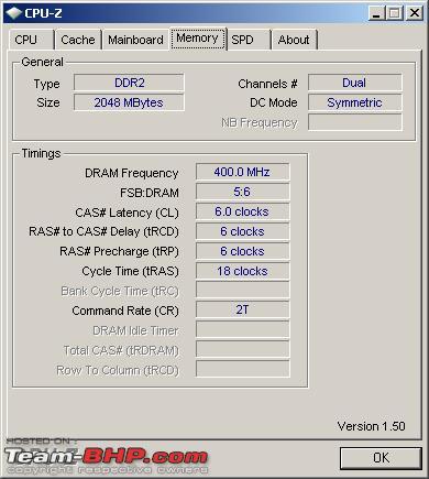

I run Windows XP SP3 and Windows 7 on this desktop. Yesterday I ran CPU-Z out of the blue on this desktop and found this - (please refer to first image in attachments; I am not able to insert it here)
It is showing one core and that too is running on 2000 MHz. I suspected it to be some BIOS configuration and explored the BIOS settings. There is I found one setting - SW Single Processor Mode, which was enabled. I disabled it and restarted the desktop.
Both XP and 7, detected the new hardware and installed it's driver, but CPU-Z still showed one core, running at 2000 MHz.
Does this mean that my desktop is not running optimally? And if not, what must I do to make it do so?
Here are the other CPU-Z screens - (please see screen-shot below)

I think it is due to SpeedStep technology. The processor reduces the speed automatically when it is not doing much work. Start some program which uses the CPU heavily (e.g. audio/video encoding) and run this tool during that time. I am sure you will see a 3GHz rating.
Alternately, BIOS might have an option to disable speedstep. You can disable it and run the tool again. However, I recommend keeping this option enabled to keep the power consumption low.

Look at the value for multiplier - 6x is the least multiplier for the Speedstep. So the processor speed will be 6 multiplied by 333.3 (Bus speed). With this window open, try doing something processor intensive like encoding a WAV to MP3 or DVD to DivX- and the multiplier should change to 9, and processor speed will get to 9 x 333.3

To my knowledge, you co annot disable the second core in a core 2 duo processor. In CPU-Z also it is showing 2 cores. you can see at the bottom. It is showing as 1 processor, 2 cores/processor, 2 threads per core. So it is definitely 1 Core 2 Duo processor. The clock speed , as it was already pointed out earlier, due the multiplier value. If you can disable speedstep in BIOS, you will get 3GHz throughout but at a cost of power utilization.
