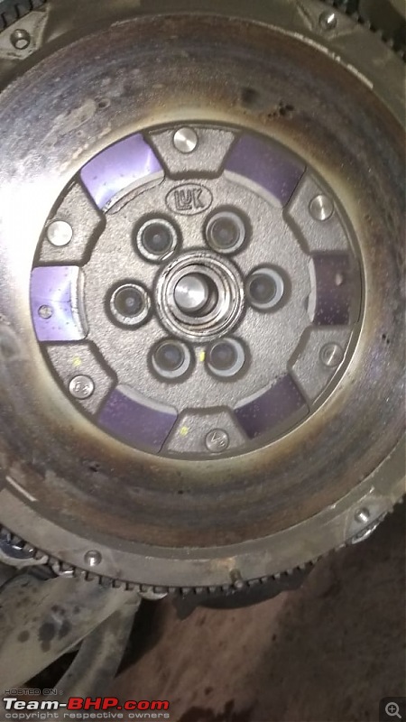

.. with a proper explanation of why and how the clutch and the flywheel got worn out. They also shared the pics of the old flywheel with me.
Could you share these details? Do you think it has to do with driving style?
There are scratch marks and burning marks on the clutch and the flywheel. The official quote/diagnosis is that it is due to the car is being driven keeping the clutch depressed partially. I for one disagree as this has never happened with any of our other vehicles. So I think it could be because-
1. There is genuinely some problem with the driving style and the VW just couldn't take the abuse.
2. Our driving style has change after taking the delivery of the VW. Though as can you imagine, this is the least likely.
3. As can be seen from my original post, the car was driven briefly after the clutch sank in. Maybe the damage happened in this short duration itself. I feel that this is most likely the case. One failure led to another.
Find the pics attached-
