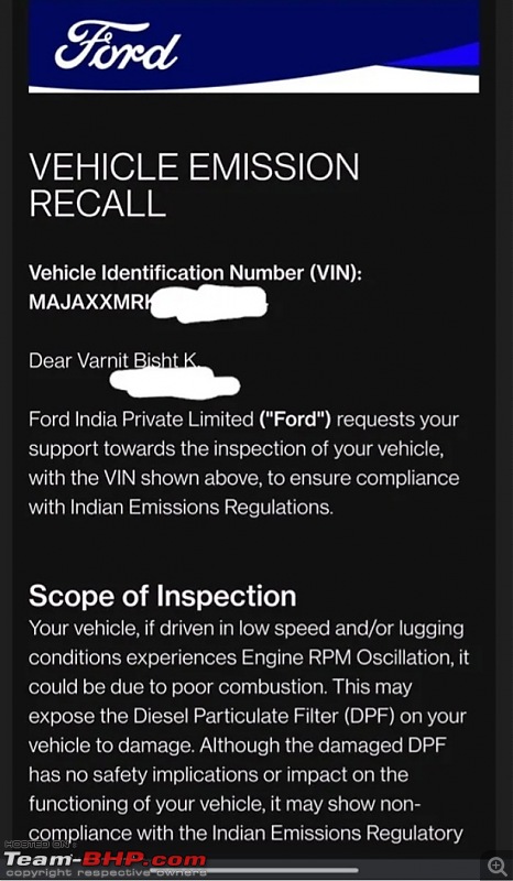

Ford India struggles with DPF problems in 1.5L TDCI | Poorly handled & utter lack of transparency-20211027_141734.jpg
This image shows that Ford has taken cognizance of the matter. It has officially recalled this vehicle to inspect the DPF of the car. Ford also informs the owner that there is no impact of this on the vehicle. If you are experiencing engine oscillations at low speeds, the reason could be poor combustion. This could potentially expose the DPF and damage it. There are no safety implications of this. However, your car might start to emit higher polluting exhaust gases than normal. This will infringe the India Emissions Regulatory body. Hence, the vehicle will be inspected by Ford to ensure that it isn’t the case. This is a great opportunity to get your Ford cars checked for such kind of issue.

Ford India struggles with DPF problems in 1.5L TDCI | Poorly handled & utter lack of transparency-inshot_20211117_111504188.jpg
It seems Ford has finally found a solution to the DPF troubles and issued a voluntary emission recall.
The carmaker has notified customers to get their vehicles inspected at their nearest Ford service station if they're experiencing engine rpm oscillations at low speeds. According to Ford, this could be due to poor combustion, which might damage the diesel particulate filter.
Ford India struggles with DPF problems in 1.5L TDCI | Poorly handled & utter lack of transparency-inshot_20211117_111724548.jpg
The inspection will only address vehicles reporting emission limits higher than those regulated under standard test conditions. To resolve the issue, Ford will replace the emission reduction components of the exhaust system and update the Powertrain Control Module (PCM) software. It would take less than half a day to rectify the problem.
Customers are requested to book an appointment by providing the Vehicle Identification Number (VIN) at the earliest.

Ford has just changed parts worth a lakh, under recall warranty for my 2021 Ecosport diesel. It mainly includes replacement of DPF and catalytic converter assembly which costs around 80k and HEGO sensor, topped up with a PCM software update.
I had power-loss issues in lower gears especially in lower RPM, intermittent higher injector clatter under load, DPF warnings and momentary power loss while releasing the clutch in 1st gear. The SC say that the recall is mainly focusing on decreasing DPF warning frequency and increasing the DPF regeneration.
Haven't driven the car extensively to rule out DPF warning frequency, but all other issues remain. They also think that there might be further hardware updates down the line.
The DPF assembly in the ES: was changed in my cousin's 2021 model today.
Ford India struggles with DPF problems in 1.5L TDCI | Poorly handled & utter lack of transparency-img20211122wa0005.jpg
I own 2021 Ecosport (Titanium diesel) for which I got the mail for recall. Contacted ford dealer regarding the same and they gave me appointment after two days. Left the car in morning and got it back in the evening after replacement of parts and PCM software update. Cost of the parts alone comes to more than 1 lac as per service advisor.
Major parts which were replaced were catalytic converter with DPF assembly, HEGO sensor and required clamps and hardware for the same. PCM software update is done online and takes more than 2 hours as per ford personnel and it really changed the behavior of the car.
Main difference I feel after the recall is reduced engine noise and better drivability in low RPM. Driven the car for around 400 Kms (70% city and 30% highway) after that and till date automatic regeneration is not triggered by ECU. Before the update my car used to perform auto regeneration in every 150 to 200 Kms (you can feel it because during auto regeneration engine becomes sluggish and idle RPM increased to 900, also instantaneous fuel efficiency reading is decreased too much in same driving condition). Ford is confident that DPF clogging issues will be stopped after the parts changed. Will update if DPF clogging issue is faced again.
