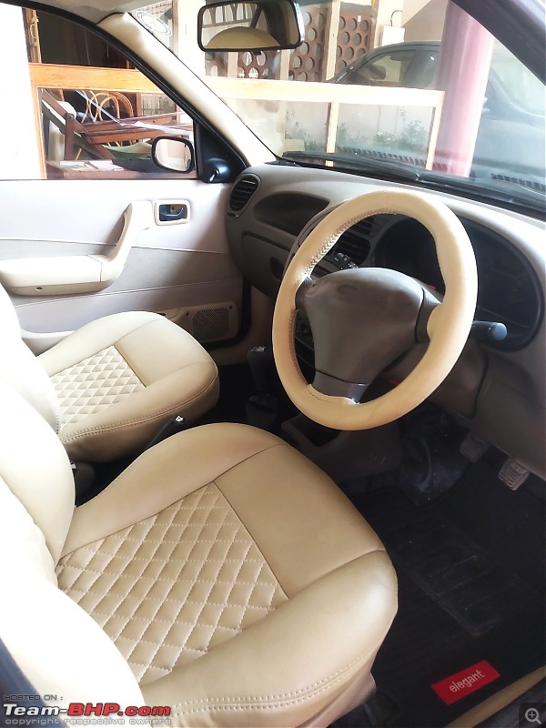

Interior cleaning and upholstery
Remote locking and stereo

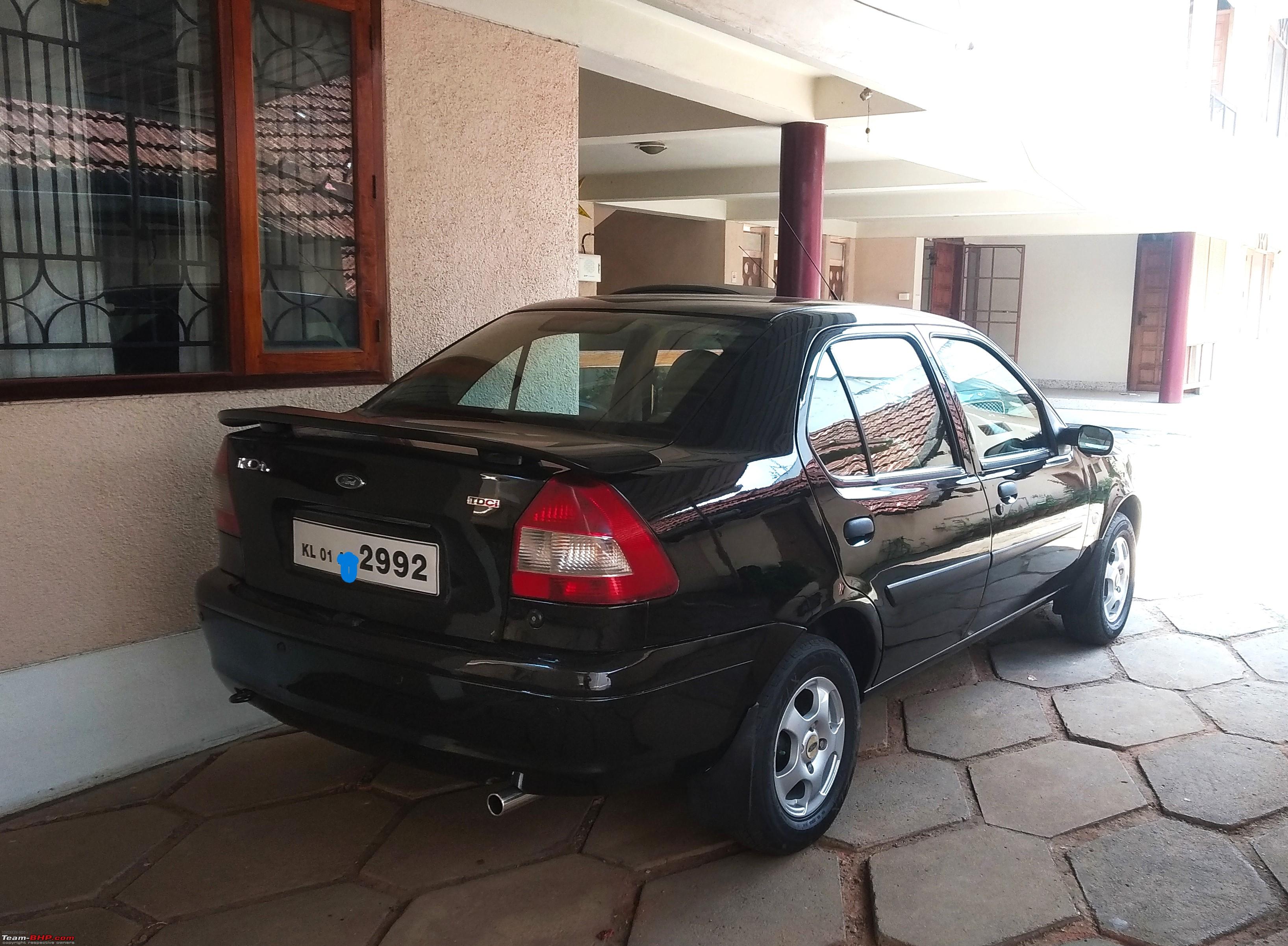

So, have been there and now done that. Without further adieu, I will let the pics do the talking.
No Sense and Sensibility | How I bought a 15-year old 1.9 lakh km Ford Ikon TDCi-photo_front.jpg
No Sense and Sensibility | How I bought a 15-year old 1.9 lakh km Ford Ikon TDCi-photo_rear.jpg
No Sense and Sensibility | How I bought a 15-year old 1.9 lakh km Ford Ikon TDCi-side_view.jpg
No Sense and Sensibility | How I bought a 15-year old 1.9 lakh km Ford Ikon TDCi-cockpit_inclined.jpg
No Sense and Sensibility | How I bought a 15-year old 1.9 lakh km Ford Ikon TDCi-cockpit.jpg
No Sense and Sensibility | How I bought a 15-year old 1.9 lakh km Ford Ikon TDCi-front_doorpad.jpg
No Sense and Sensibility | How I bought a 15-year old 1.9 lakh km Ford Ikon TDCi-back_seat.jpg
No Sense and Sensibility | How I bought a 15-year old 1.9 lakh km Ford Ikon TDCi-rear_seat_cushion.jpg
