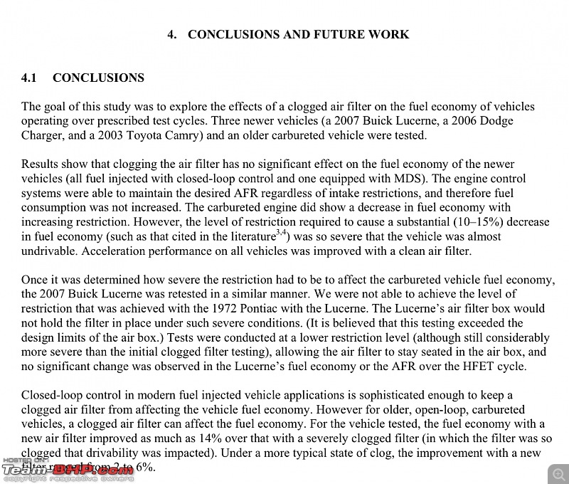

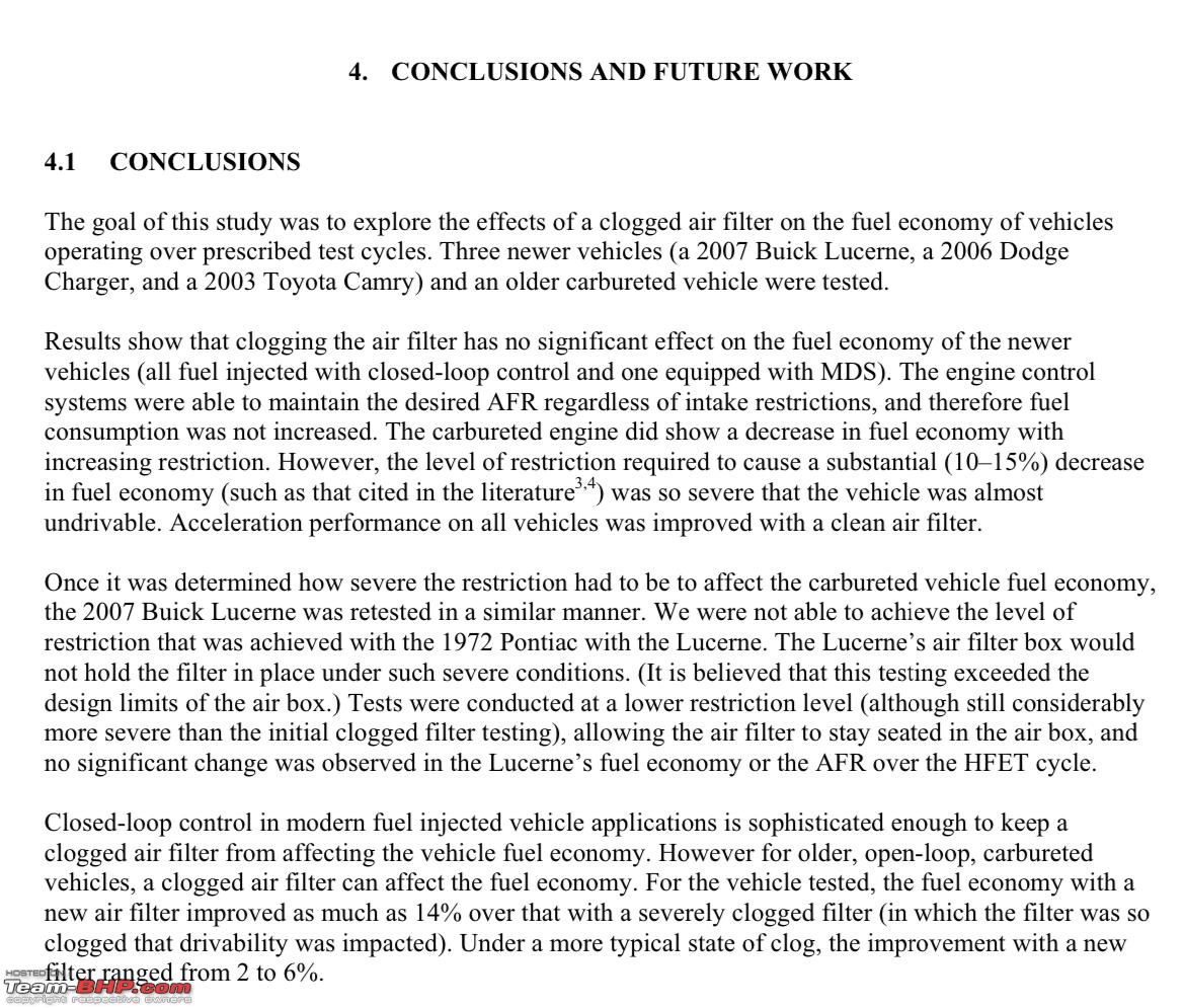

1. If dirty air filter doesn't affects the mileage in newer cars, wont the mileage drop if one presses pedal to metal to overcome the sluggish acceleration due to clogged filter?
Pressing the accelerator harder will obviously draw more fuel to the engine. I understand the engine won't pump more fuel by itself but the driver will push the pedal harder to overcome the sluggishness. And i think older carb car will be affected the same. Correct me if i am wrong, sir.
2. I understand carb engines had mechanical fuel pump which was operated by crankshaft and new ECU engines have electrical fuel pumps. The carb fuel filter used to be small netted cylinder and modern fuel filters are much better. But often in restoration posts we have read the fuel lines and pump got clogged due to rust and debris in fuel tank. Now these vehicles are mainly carb ones.
So in such cases, does the fuel filter can't perform its job or it is simply too small for debris or the lines get clogged before reaching the filter??
For;
1) There is a study specifically done for this, I have attached the picture of the conclusion. If you want the full technical report, let me know.
2) Jeroen have answered you on this.

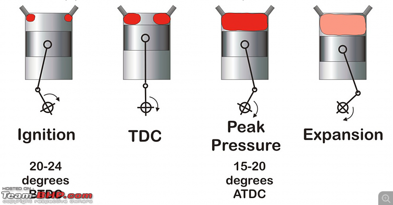

In addition to NomadSK excellent write-up on this topic, I thought I would add a bit more detail on some of the other aspects relating to this topic. Some members have already mentioned ignition advance, engine knock in relation to the octane number of a fuel
Let's first look at some basic terminology. Three terms come into play, knock, detonation and pre-ignition.
I am borrowing various bits of text and images from the internet.
People often describe the process of petrol being ignited inside the cylinders of a regular petrol engine (technically an Otto cycle) as being akin to an explosion. Something that happens instantaneously. It is not! The air-fuel mixture does not explode when ignited by the spark plug. It burns evenly across the combustion chamber, starting from the spark plug. It is fast, but it is not an explosion, it needs to be very well controlled. Depending on the engine it takes anywhere from 60-90 degrees of crankshaft rotation. If you factor in typical engine RPM you can calculate the ignition time. (3-8 mili seconds or thereabout)

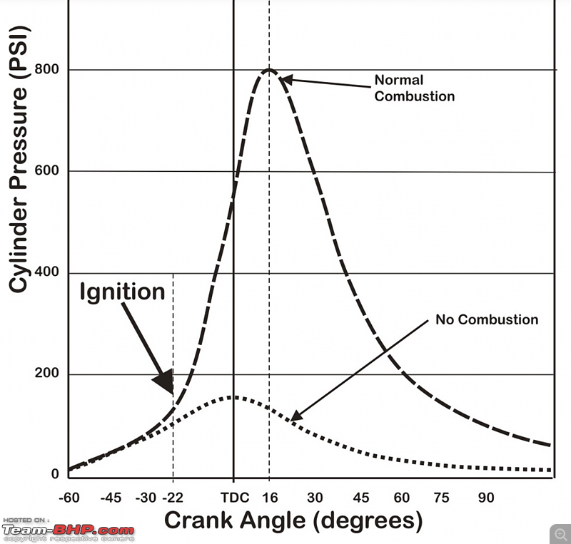

As the mixture starts to ignite the pressure inside the cylinder increases rapidly. The timing needs to be so that the peak pressure occurs well past TDC (Top Dead Centre). If the piston/crankshaft can only produce torque/power during its expansion stroke, so past the TDC.
Explained : Octane Number, Cetane Number, Fuel Myths & Mixing Different Fuels-screenshot-20230827-7.26.32-am.png
Here you see a graph depicting the pressure inside the cylinder versus crank angle degrees.
Explained : Octane Number, Cetane Number, Fuel Myths & Mixing Different Fuels-screenshot-20230827-7.27.15-am.png
If the combustion process moves too fast and the pressure peak occurs too early, the result can be excessive pressure, excessive temperatures, and unstable pressure pulses known as “detonation.” That’s because when the piston is near TDC, it can’t move downward in the cylinder to relieve the pressure (and accomplish some useful work in the process).
