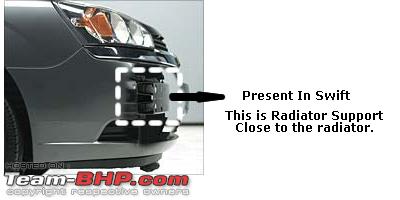

It might things if somebody can post pictures of the "bumper reinforcements" on Santro and Swift. I know for sure that my Swift has a round metallic rod running from left to right just in front of the radiator. But Gangsta says that is only a radiator protector.
Anyways this is what i was talking about.
I bet you guys are getting confused bet. the supporter and the actual beam aka bumper rail aka bumper reinforcement bar.
This is the cross section of the bumper.
There are 2 bars in the cross section.
1. Close to the radiator.
2. 3-4 Inches away from the inner plate.
Swift has this thing in the 3rd pic. close to the radiator. Check out the 2nd pic., this is not present in the swift. This is what i was talking about. Now if you are saying you see 1 bar near the radiator, then hyundai cars have 2 lol. because support will be there in the cars and the other hand bumper rail is also there in Hyundai cars.
Please check out your swift once again in the daylight. You wont find 2 bars in Swift. i.e the one close to the bumper plastic cover. It is Hollow.
Push your bumper with a thumb and it will go inside because it is hollow. Try pushing with same force in Accent, getz etc. It wont press that much because rail is covered with a hard foam and then we have bumper plastic means its not hollow.
It is very much present in the swift. It's just a different design. That is all.

It is not 2 beams. It is just one. It consists of two heavy gauge steel tubes held together by three plates. Two at either end and one in the center. This part is just below the bumper. In fact when you push the front bumper inwards you will notice that it moves in about half an inch and then stops moving. This is the piece that stops the bumper moving backwards. The distance between this and the radiator will be at least a couple of inches.

Attaching a picture of the beam for reference. This belongs to the petrol version, don't know if it is the same for the diesel version as well.
Is the Swift prone to accidents?-13howtoremovethefrontbumperfromasuzukiswiftoncedrytherustisneutralizedanditturnsblack1024x768.jpg
Source: http://www.suzukiswift.info/wp-conte...k-1024x768.jpg
