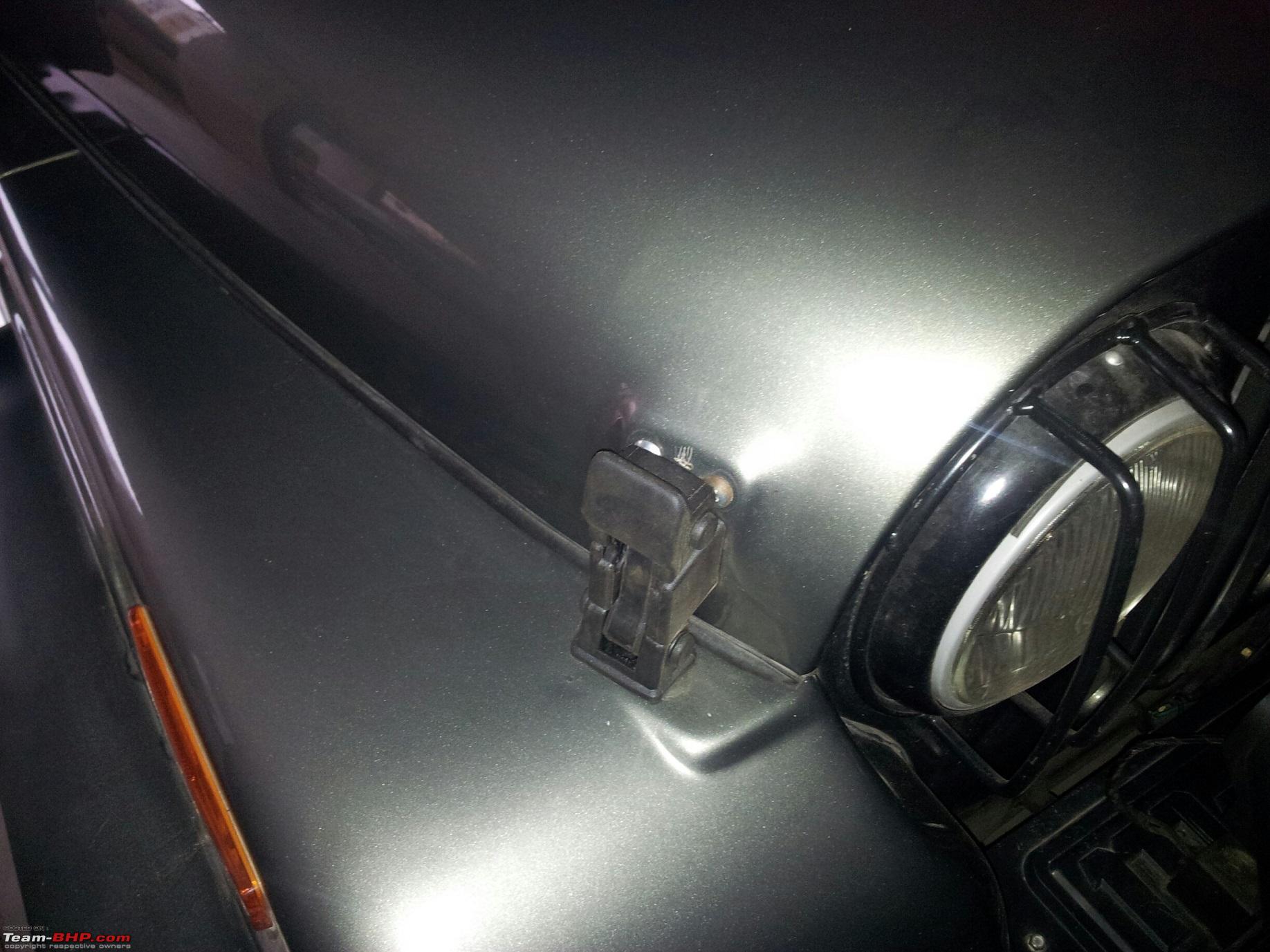

1. Jeep Wrangler Hood catch (rugged-ridge) - bought through e-Bay; looks good and avoids scratches on the hood!

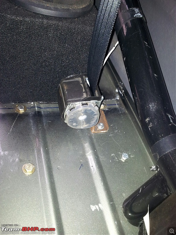

Sure Vishal, here they are!
Please note that two holes (with pre-welded nuts) have been provided on the floor, around 5" from the rear door. However, I did not use these due to two reasons.
1) It limits the luggage space at the rear (behind the front-facing rear seat)
2) The belt will be at a slope from the top mount (on the roll-over bar) and the mounting on the floor, fouling with the speakers I have installed in the rear corners. (you can see my speaker installation in Image 1)
However, if you do not want to drill additional holes on the body, you can use the pre-drilled holes (with welded nuts) without any problems.

A couple of close-up images of the Rugged Ridge hood latches from Jeep Wrangler:

I have following questions:
1. Maruti Omini front seat belt with motor/pulley costing 2500 and without motor/pulley costing 850 for single set, I think the later one is useless. Do you think first one is VFM? any other options?
2. Considering the space between roll over bar (where the seat belt is fitted) and seat, is the seat belt effectively holding the passenger?
3. Padding the SA Roll Over bar is on my list as well. Have you thought of covering wheel arches with soft materiel which will be used as seat extension?

Vishal, thanks!
1. Go in for Maruti Gypsy seatbelts, the ones from the Omni are too short, I learnt it the hard way!
2. Yes, it is highly effective, you are almost glued to your seat! Also, please remember if the vehicle topples, the SA roll-over bar is better suited to hold than the Targa band of the Jeep, it is for this reason that Thars sold abroad have seat belts fitted to the SA roll-over bar.

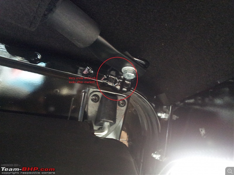

The 'X' member attaching the front wind-screen section to the targa band is a different story though!
The way the clamps have been welded above the windscreen is sad, looks like an after-market job!
The attachment to the targa band is relatively better, but the 'X' member has just been fastened to one of the existing bolt/nuts! However, in comparison, it looks better than the attachment at the front!

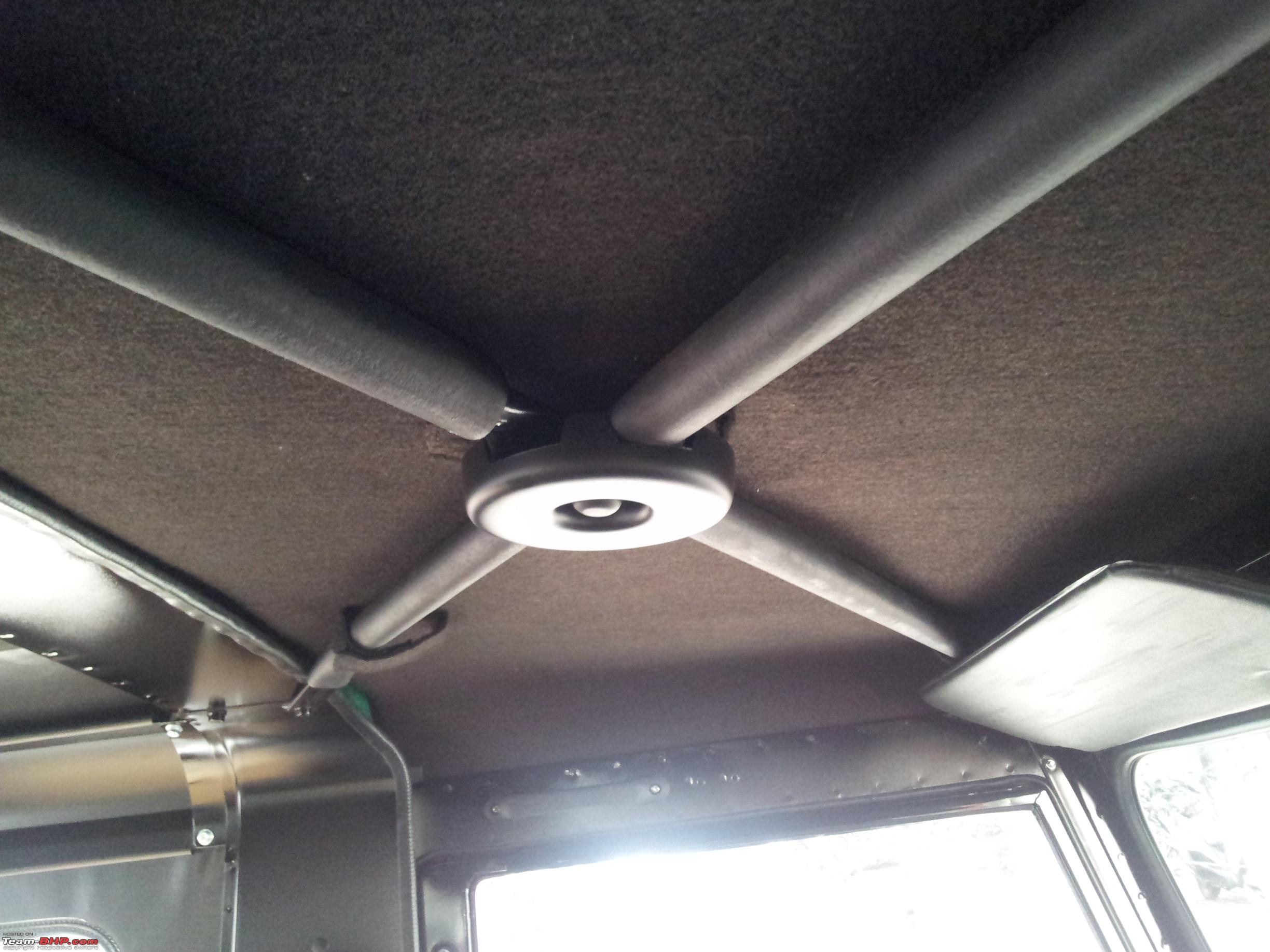

The 'X' member by itself, looks quite decent. If the fastening of the 'X' member to the A and B pillars was done more professionally, the 'improvement' or 'modification' would have appeared factory-fitted rather than 'jugaad'!
There is a velcro strip holding the (hard portion of the) soft-top to the 'X' member.
