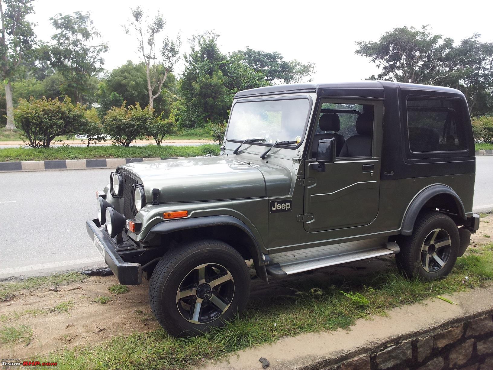

Further mods!
An update after quite sometime
1. Jeep Wrangler Hood catch (rugged-ridge) - bought through e-Bay; looks good and avoids scratches on the hood!
2. Bolero ZLX door mirrors - The field of vision in the original Thar door mirrors is limited, often scary due to pronounced blind spots, a direct fit to the existing holes. Mirrors can be painted body-colour (if required), I prefer black. Also, the surface of the mirrors is smooth and prevents wind-noise at high road speeds. Tested up to 120 kmph.
3. OE wiper blades replaced with Hella Dyna-edge; remarkable difference in cleaning ability!
4. Rear seat-belt installation - Shifted the front OE seat-belts to the rear (requires the fabrication of a support at the bottom) and fixed Maruti Swift's seat-belts at the front! Just adding to the security to the children at the rear, who other-wise could get thrown about!

Sure Vishal, here they are!
Please note that two holes (with pre-welded nuts) have been provided on the floor, around 5" from the rear door. However, I did not use these due to two reasons.
1) It limits the luggage space at the rear (behind the front-facing rear seat)
2) The belt will be at a slope from the top mount (on the roll-over bar) and the mounting on the floor, fouling with the speakers I have installed in the rear corners. (you can see my speaker installation in Image 1)
However, if you do not want to drill additional holes on the body, you can use the pre-drilled holes (with welded nuts) without any problems.

And finally, the typical Jeep look with the front insect mesh discarded!
P.S. Image not very clear because picture shot in night mode - with limited light

The Indian Jeep Wrangler
The raw authentic Jeep look, the way I like it!
