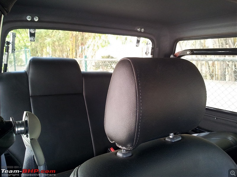

After quite sometime I decided that my rear seats needed to grow-up!
My children found the customized 2-seater to be very uncomfortable.
Prowling and searching in the Shivajinagar gujuri, I managed to purchase the rear seat of an Indica!
I wanted to retain full functionality, the entire length, split (40:60), double-foldable!
Simultaneously, I wanted to install the X cross-member between the front wind-screen frame and the targa band, which is present in the current crop of Thars.

Installation of the Tata Indica rear seats: The previously installed modified Tavera seat was removed and the MS angles seat frame was used to fabricate the new frame.
The new frame was designed such that the seat did not rest on the wheel-wel but was raised by around 10 mm. The seat is fastened to the front of the frame with four bolts (and nuts) and this can swivel (for folding the seat).
Technically, the rear of the seat can just rest on the frame, since the back-rest is locked at either end. However, to prevent rattling, I used four bolts and nuts, with the nuts welded to the seat bottom. Whenever I want to fold the seat, I just need to unfasten the four bolts from the bottom.

The back-rest is supported indirectly by a square tube, it is an intricate design. The square tube is welded to two MS flats on either end, which in turn have been bent to follow the shape of the SA roll cage.
The MS flat is fastened to the SA roll cage using the existing seat-belt mounting points, bottom-line is that the SA roll-cage has been used as a primary support with no welds anywhere which could reduce its strength.
At either ends of the square tube, two loops made of MS have been welded, the locking mechanism in the back rest of the seat lock on to this!
Pictures of the completed rear-seat installation:
Remarks: The sitting position (height) has definitely increased compared to the previous arrangement, since the sitting surface is above the wheel well. However, the angle of the back-rest has been so-arranged to maximize head-room available at the rear. A person of height up to 5' 6" can comfortably sit at the rear, for the taller ones, the two integrated seat-belts are an absolute necessity!
