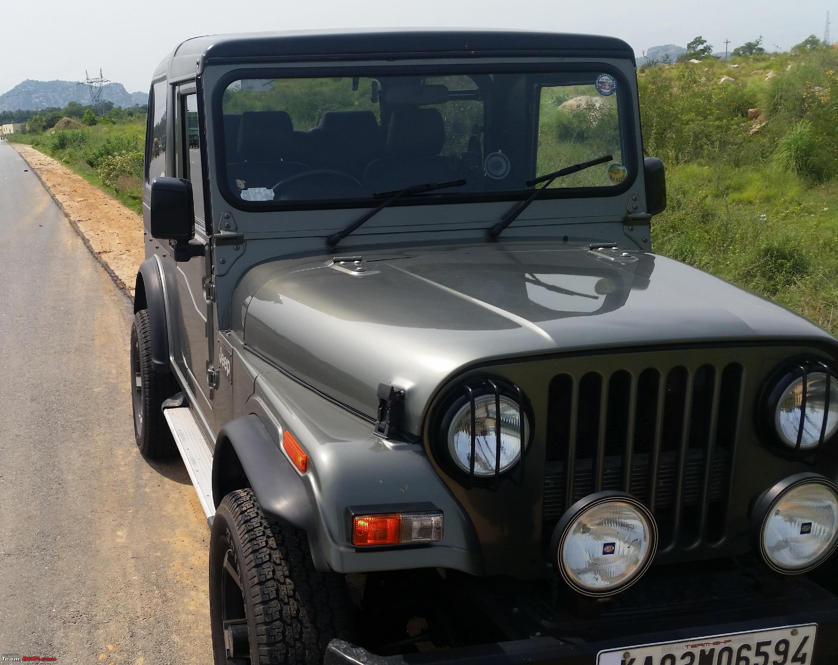

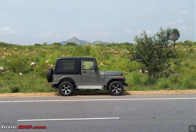

Re: Call of the wild - Mahindra Thar CRDe
Just completed a 460 km journey in my Jeep CRD - it's the first time I undertook such a long journey in a Jeep - in ONE day!
Pit-stop enroute to Vellore!
I have to admit, increasing the rear wheel-track to match the front has made a tremendous difference to the vehicle dynamics!
Gone is the nervousness when attacking curves at high speeds (with the feeling that the Jeep may fishtail)
Maintaining a steady 110 kmph throughout the journey (2500 rpm), it is incredible driving a Jeep on expressways - the towering feeling allows one to maintain constant high speeds!
The downside however is the fuel efficiency - 10 kmpl with the air conditioner at full-blast throughout to subdue the mid-day heat
A couple of pictures which highlight the stance of the vehicle!
