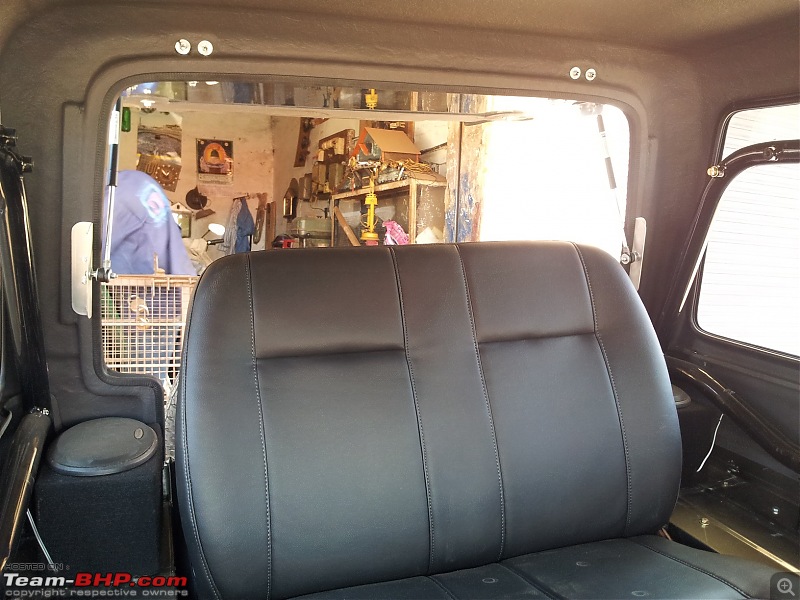

After fitting the Honda City seats up-from, ingress into the rear from in-between the seats had become a major problem. In addition, I found the front seats themselves were a bit too low for my liking.
Two changes were planned
1. Raise the driver's seat by 2" in the front and 1' in the rear. The seat frame was modified accordingly - the driver's seat is now ultra-comfortable!
2. The area under the tool box (below the front passenger's seat) is rust prone. In all my Jeeps, I have removed the tool box. So I removed the tool box in the current Jeep, and as expected, water stagnation marks were seen inside (uncovered holes at the bottom!). I have designed a new frame for the passenger seat, and made it foldable. WIP pictures are posted, there has been a slight change after the picture was taken, the seat is now hinged at the RHS side and not at the front. Two clips hold the seat in place, when in position. P.S. The new frame has been fixed to pre-existing holes on the floor, probably provided for seat fixing in the LHD export models!
Shall post detailed pictures shortly! I have posted close-up pictures of recently modified rear bench seat.
