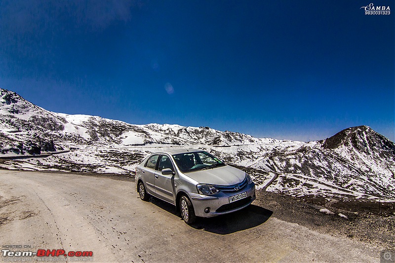

Odo reading is a tad short 58,000kms and the car is again back from a 1425 kms long drive to the Himalaya's ! (Old silk route East Sikkim) :D
Few observation's-
Car is holding tight.
No rattles or any unwanted surprises.
The Ac was a chiller and kept us cool in the mid day hot & humid weather. Plus the cooled glove box helped us to keep our cold drinks and red bull cans chilled.
Performed flawlessly yet again for the whole trip.
The Yokohama Earth one was excellent to drive on snow.
The overall mileage for the trip was 13.5kms/ltr with 90% Ac & some heavy foot driving.
The stock clutch plate is still holding well.
Some how the engine feels more eager than before on the highways!
No power loss or any clogging in air filter at altitudes over 14,000 feet.
The Exide battery is holding up well too, plus no cold start issues in chilling early morning temperatures.
Few pics from the trip- :)
