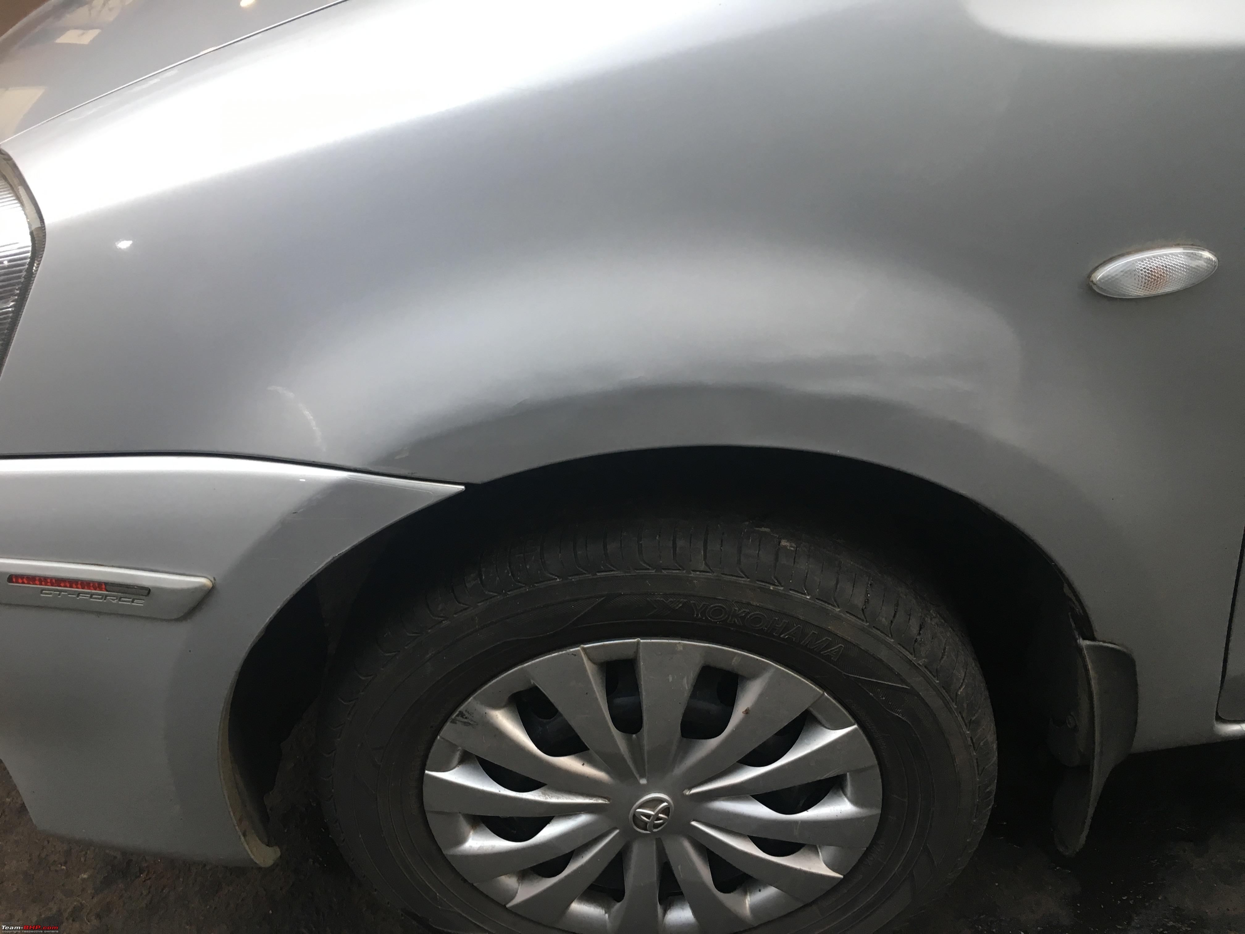

Last week my parked Etios was hit by an Innova. While reversing, the Innova driver misjudged his car's length and damaged the front fender of my Etios. :Frustrati
The first major damage in 7.5 years of its life.
Toyota Etios 1.5L Petrol : An owner's point of view. EDIT: 10+ years and 100,000+ kms up!-img_0005.jpg
The Innova guy immediately admitted his fault and brought a body mechanic from a nearby shop and asked him to repair it.
That guy managed up-to this much in 30 minutes.
Toyota Etios 1.5L Petrol : An owner's point of view. EDIT: 10+ years and 100,000+ kms up!-img_0008.jpg
He made it look better but i was not satisfied. So decided to give the car in my FNG for a proper denting and painting job.
While giving the car, i asked my FNG guys to paint the left running panel, a portion of the rear left wheel arch and both the ORVM covers for some minor scratches.
A full body polish with an interior and engine bay cleaning was also included.
Total damage to pocket - Rs 5,000.
I have not claimed insurance, as i wanted to saved the ncb which i got in the last 7 years.
The work done was satisfactory. The new paint shade, more or less matched with the original paint. If noticed very carefully the new shade is a tad bit darker. Overall am satisfied with the job done. :thumbs up
