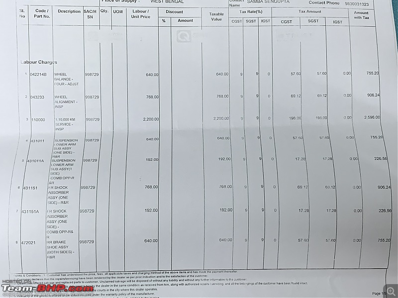

Total bill- Rs 32,186
Attaching the cost details-

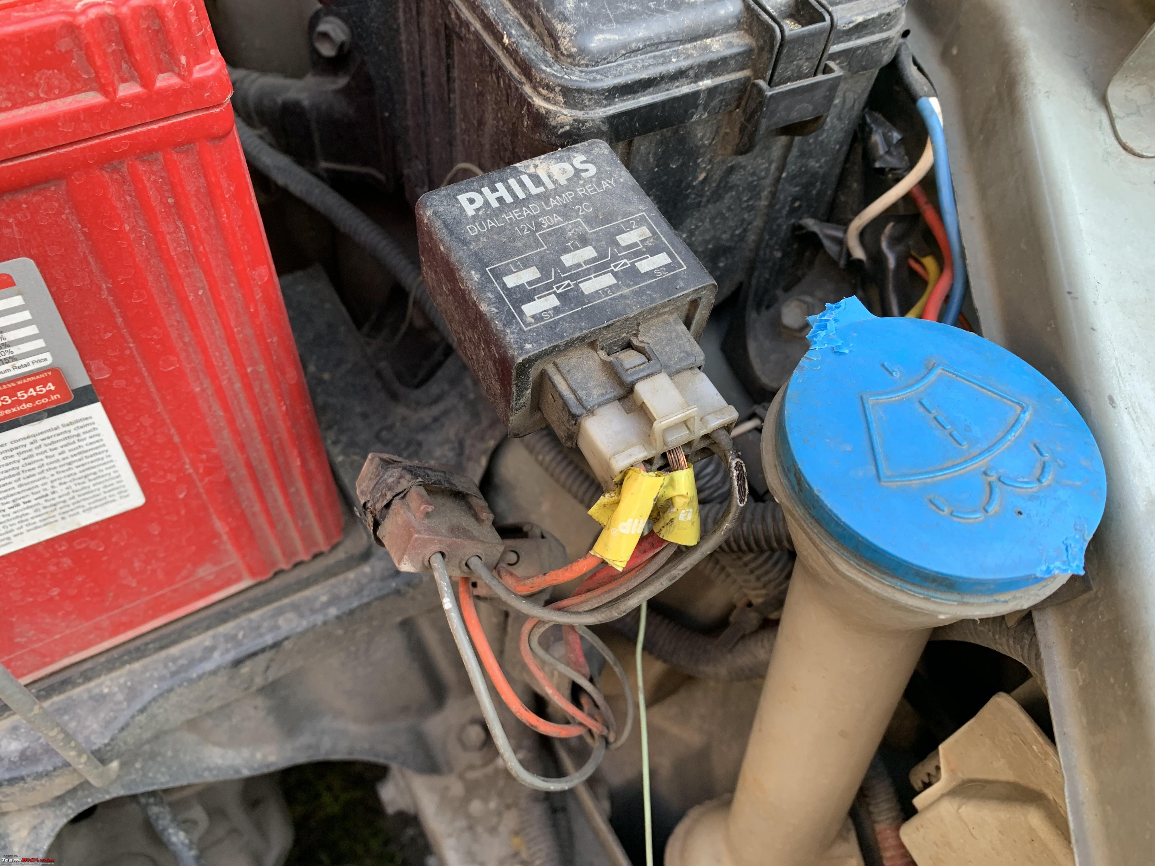

Off-late, I find the headlight illumination to be a tad less. The seal-beams are 10 years old now.
Before replacing the headlights, will replace the bulbs and see first. The current set of bulbs are now nearing 5 years.
Ordered two Osram H4 90/100 bulbs. The relay is fine. So will just change the bulbs and see if their is any improvement or not.

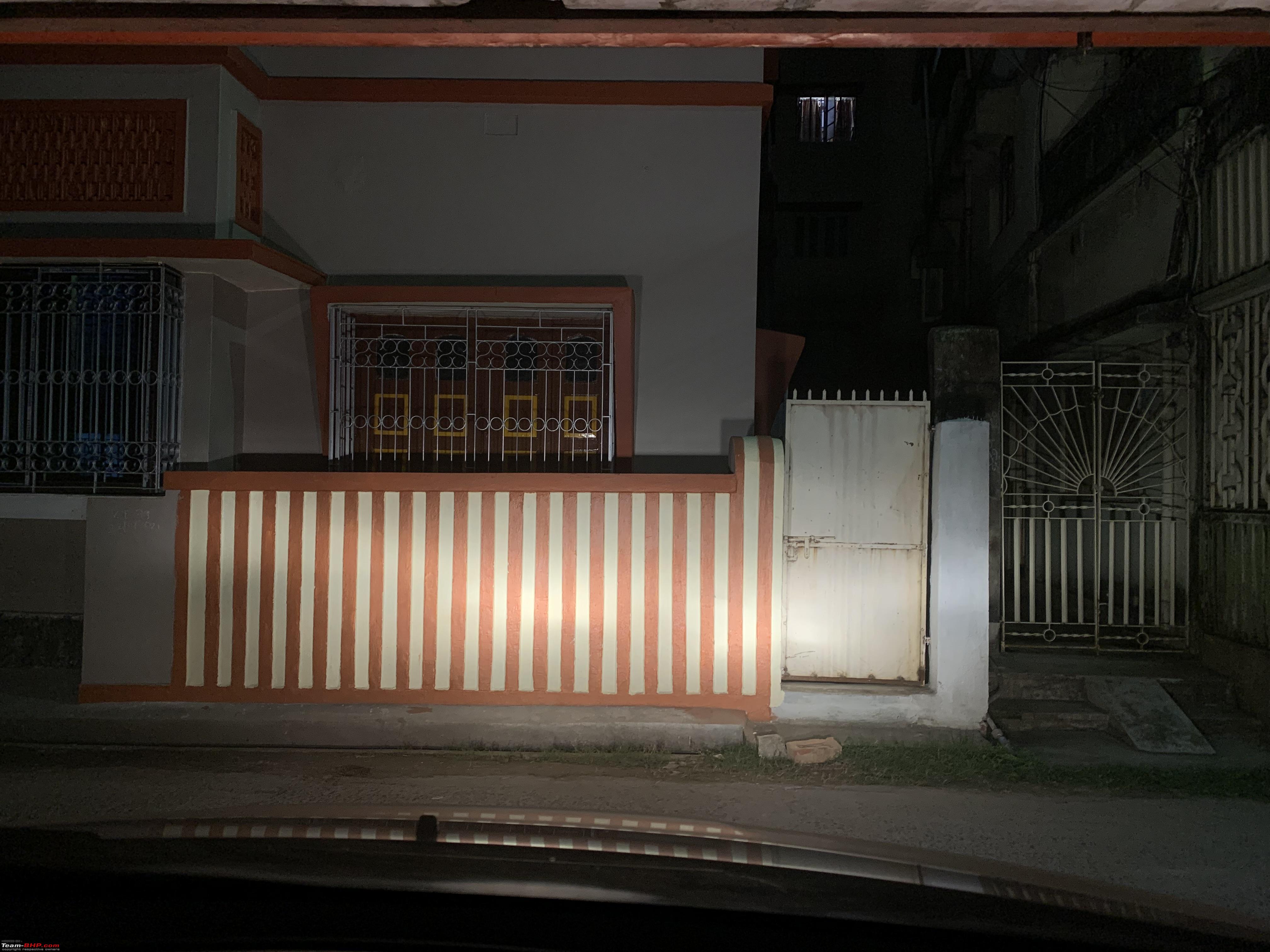

Changed the bulbs to Osram 90/100 and the road was still not properly illuminated.
Later I figured out, the adjuster of the left headlight was not working and the light was not properly focused. So took some time and I adjusted the seal beam level by pressing it from behind. After the adjustment, drove for 300-400 km, it's holding up fine. The light is sufficient now.
As of now changing of the headlights are not required.
Sharing the pics of the light with the new bulbs and after adjusting the headlight levels.

The headlight relay wire has been cut, plus the rats chewed the cap of the wiper washer fluid reservoir. The left indicator placed on the fender was not working.
Toyota Etios 1.5L Petrol : An owner's point of view. EDIT: 10+ years and 100,000+ kms up!-img_1666.jpg
The very next day, I took my car to Saini Toyota.
Thankfully, they told me they will repair this. Else the whole wiring kit which comes with the engine is very costly. The mechanics checked thoroughly and confirmed that, mostly the wires were intact, the wire covers have been chewed.
So they took the car inside and repaired the damage thoroughly with insulation tape.
Damage to pocket- Rs 1,000
Pics post repair. Now everything is working perfectly.
Toyota Etios 1.5L Petrol : An owner's point of view. EDIT: 10+ years and 100,000+ kms up!-img_1676.jpg
Toyota Etios 1.5L Petrol : An owner's point of view. EDIT: 10+ years and 100,000+ kms up!-img_1677.jpg
Came home and placed camphor on the engine bay and sprayed rat repellent on all the wires. Sealed all the small entry exit places for rats.
Now am regularly keeping an eye on the car. Hope I manged to keep the rats away for the time being.
