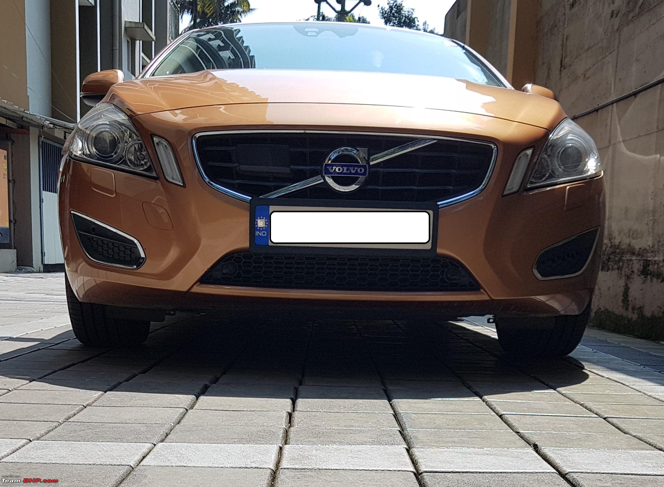

Tyre upsize again at 69,000km !
My front tyre had developed a bulge a few months back. I had it patched on the inside at a local shop (not recommended, I know) and rotated the wheel onto the back. The tyres had a few thousand kms left on them. Thus I wanted all four worn out till I change them. I was also considering whether to change the car at that time, so kept everything on hold. Having a space saver spare also gave me some confidence in the matter. Only problem was I couldn't go on long trips with a tyre bulge.
Cut to few weeks back, the tread wear indicators started nearing their limits. The road conditions here are bad in certain sections. Also the recurrent road flooding after heavy rains recently got me thinking about further upsizing the tyres. I wanted to stick to the Michelin Primacys as they offer the ideal compromise between comfort and dynamics. The new Primacy 4 series is supposed to be even better then their predecessors with a little stiffer side walls, apparently without compromise on performance.
The stock tyres were 215/50 R17 Continentals. Years ago I had upsized to 225/45 R17 Michelin P3ST which were within recommended limits. Subsequently I changed to 225/50 R17 P3ST which offered a little more ground clearance. These were slightly off limits but still ok. Michelin has now come with near 'SUVish' 225/55 R17s in their Primacy 4 series. I did some research online. Although they were grossly out of the recommended upsize range, it was not dangerously so. So I decided to take the plunge and changed to this size.
Volvo S60 D5 Ownership Review : 13 years 115,000 km update!-ground-clearance-side.jpg
The stance has definitely changed on side profile
Volvo S60 D5 Ownership Review : 13 years 115,000 km update!-wheel-arch-gap.jpg
The fender gap has reduced considerably
Volvo S60 D5 Ownership Review : 13 years 115,000 km update!-fender-gap-full-lock.jpg
This is the gap at full steering lock to right. This appears to be the limit to which you can upsize on this car. One of the members in our Volvo group is a tyre dealer and he has confirmed the same. Also he is confident that this is the ideal upsize.
At the wheel alignment center, when the car was lowered from the car jack after the tyre change, I had a little fear of whether the fender would scrape the front tyre on turns. Had I gone too far this time ? I was advised to keep tyre pressures at 30 psi (unless on full load) and reassured that I will be good to go.
The ride has definitely become more comfortable with the additional profile. So that bit is definitely sorted. How the suspension will take this change, only time will tell (I hope it won't ). I did some reasonably spirited driving and corner carving around the twisties over here. Also checked it over some bad roads. There were no issues of the suspension bottoming out or the fender arch scraping the tyre. There is a noticeable difference in rolling resistance. However, no change in braking performance was evident for my driving style.
Volvo S60 D5 Ownership Review : 13 years 115,000 km update!-ground-clearance.jpg
This is the ground clearance now. In places were I used to tip toe over humps and undulations, I now confidently glide over them.
Volvo S60 D5 Ownership Review : 13 years 115,000 km update!-ground-clearance-front.jpg
Front stance
Volvo S60 D5 Ownership Review : 13 years 115,000 km update!-ground-clearance-rear.jpg
With the 55 profile the rear has an almost SUVish stance a-la the S60 CC. The latter of course has significantly more clearance and larger 18 inch wheels. Not to mention a Haldex AWD drivetrain.
