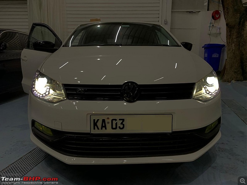

The install itself was quite straight-forward, especially with the custom harness that was provided along with the headlights.
Couple of interesting things about these Bixenons:
- These are the original (made in Spain) by Valeo OEM Bixenon headlights (35w) Philips HID bulbs and Mitsubishi ballasts, specifically for the RHD markets like RSA and the UK.
- To get the maximum out of these, it would be necessary to swap out the stock BCM and wiring with BCM-Max - this opens up a host of features such as self-leveling/auto focus, cornering lights on steering-angle, etc.
- To work around this, many enthusiasts in RUS and EU have developed an 10-14 pin adapter / wiring kit / module which helps enable some of the features that BCM-Max would unlock:
GT'ing around in my VW Polo TSI | Update: SOLD!-11.jpg
This 'Module' unlocks the following:
(a) Cornering lights on Indication
(b) DRLs activate on ignition
(c) DRLs dim when headlights are switched on
(d) DRL turns off when respective indicator is activated
(e) Cornering lights activate when respective indicator is activated
(f) HID bulbs activate and shutter opens for flashing when headlights are off during the daytime.
- Unfortunately, the one feature that still requires BCM Max to work is the auto-focus / self-leveling function. This works with BCM Max only and requires a sensor to be fixed on the rear axle which transmits signals to the BCM to focus the beam based on load and weight in the car. Ergo, my Bixenons are fixed and cannot be adjusted unless I pop the bonnet and aligned them manually. Below are pictures of low and high beams pre-manual-alignment:

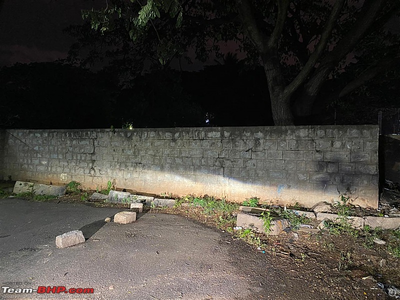

Low beam (yet to be manually aligned)
GT'ing around in my VW Polo TSI | Update: SOLD!-12.jpg
High beam (yet to be manually aligned)
GT'ing around in my VW Polo TSI | Update: SOLD!-13.jpg

Verdict:
Well, what can I say. The performance is a night-and-day difference when compared to the crappy halogens. The spread is wide and the throw is good too. It does has the intensity that some of the other options lack, and although the beam's cut-off is not super-sharp with the rainbow colours, it's pretty clean and effective.
What I was concerned about is its performance in the rain and I haven't been left wanting in that respect either.
There is definitely room for improvement (I have seen some spectacularly performing headlights in the aftermarket) but these do the job for me just fine! I couldn't have asked or expected anything better. For now, here are some pictures I have taken:

Originally Posted by Reinhard View Post
One doubt - now that your primary headlamp itself is a bi-xenon HID - how do you find the performance of high-beam flash for passing? I have always been a bit skeptical of this since a pass-flash means the ballasts generating the startup-surge for the bulbs.
Good point there sir. Since I have HID's too and use the high-beam flash, I have got into the habit of switching ON the headlights and driving around in low-beam be it in any part of the day.
The surge when pass function is used when headlights are OFF, shortens the life of the bulb hence I prefer having then ON always.
Old 11th September 2020, 11:36   #225
Vid6639's Avatar
Posts: 17,690
Thanked: 44,154 Times
Originally Posted by adi_petrolhead View Post
Now while you note that the difference is night and day, you should consider looking at XB 55W Ballasts and XB 5500K from Morimoto. You will then see the difference is "day-and-twice as bright a day". The 55W ballast will run the standard bulbs at 50W, and color shift will cause light to be yellow-ish. Hence recommend to get 5500K bulbs, which will give 4500K output with the 55W ballast. Still slightly whiter than OEM 35W which is 41-4200K. You will not regret this mod, and it only costs 18K for this set up.
The bulb is a D3S bulb which has ballast built in. I am not in favour of 55W HID bulbs for the heat.
Also when you flash to pass it is a cold start and with 55W there will be a big surge. Life of bulb will be really bad vs the cost spent.
You are right the HID for passing will not be fully warmed up. The flash will be around 40% bright and will generate huge surge for the quick pass.
The more you use the flash to pass the less life of the bulb.
This is the bulb used:
https://www.morimotohid.com/morimoto...lbs?quantity=1
The ballast is part of bulb so if you pop the bulb it's ~$100
