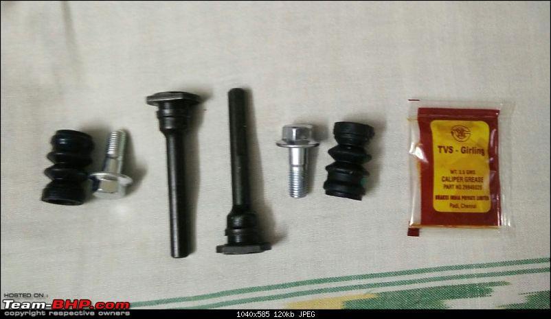

Originally Posted by paragsachania (Post 4319110)
Regular greasing will keep the noise at bay. That is the only solution.
The other option is to change the pins every 20-30K kms as a pair costs 4XX for both sides. The Labor is usually covered as part of "caliper pin greasing" that they always include.
To arrest this noise for a longer duration, there are a lot of jugaads
Well, mine were changed at 20K servicing, and now again at approx 30K - so looking at it, I feel like a simple greasing should have prevented this change. Well cant comment on it now - lets see for how long these lasts. Now since I know the type of noise to look out for, and don't need MASS for troubleshooting, would get them greased/replaced from known garage at fraction of cost.
And man, your "jugaads" are indeed dangerous ! I would/should rather stay away from them!
Originally Posted by aerohit (Post 4319223)
Local shops including MASS are sometimes known to use regular grease instead of caliper grease. When caliper get very hot it burns the regular grease leaving the pin dry with hard carbon deposits. Driving in water can also wash away caliper grease.
If I recollect, the grease which MASS used was of bright orange color - 2 small sachets, one for each pin. And the quantity was such that it was all consumed by that pin and the whereabouts. Don't know if these were a part of new pin assembly or was an add-on.
The sachets come both as a part of the caliper pin assembly, and are available separately also. Separately, they cost 13 rupees and 33 rupees for 2 different size of sachets.

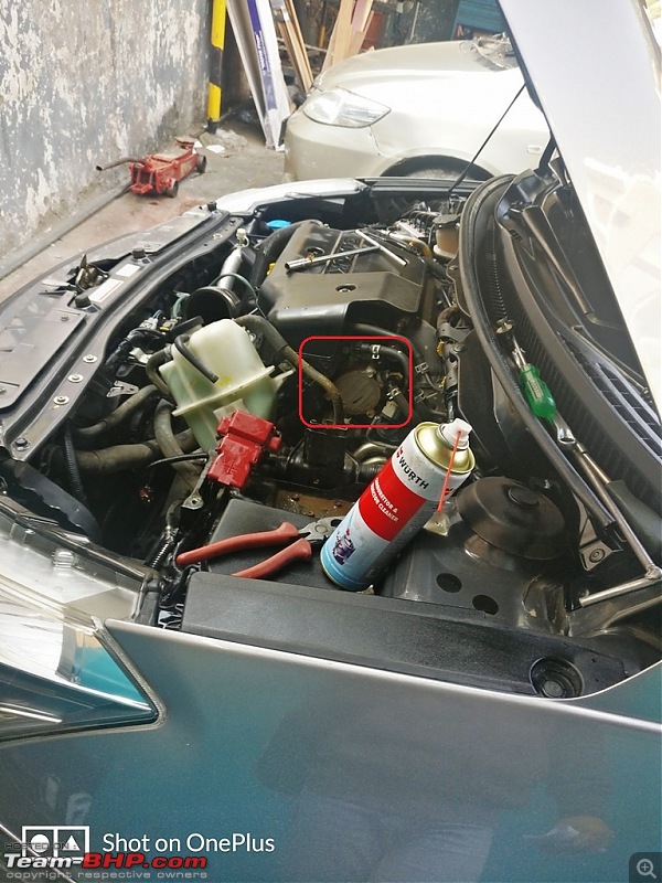

Second update, got the 30,000 kms servicing done via Qutab Auto Gurgaon.
Normal routine stuff, taking into consideration what was done in last servicing. EGR valve cleaning was included as well. With fully synthetic oil ( https://www.amazon.in/Mobil-Super-5W...inhydr18418-21 ) , the total cost of servicing after discount came out to be about 4500/- - I just love this running cost !
No wheel balancing and rotation - they were charging 850 for that ! Till date, I have not yet got the alignment done - the car is steady straight - why do I even have to mess with it ? I have seen alignment gone haywire when these people play around with it. So for now, I am just doing wheel balancing and rotation.
3M underbody coating is holding well - no cracks or peeling seen on underbody.
