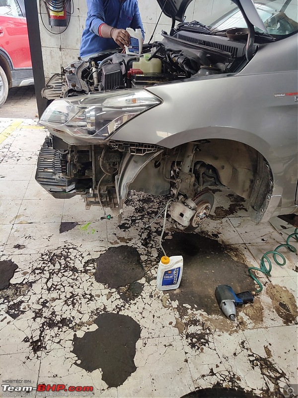

Brake Oil replaced. Brake pads inspected and cleaned. No oil leakage from rear drums.
Intercooler removed, cleaned with diesel. Finally, cleaned it with high pressure air. Lots and Lots of dust cleaned. Living in NCR and its demerits. Poor lungs, what all they have been going through :eek:
With intercooler and front bumper removed, it was a perfect combination for pressure wash of condenser. Again lots of dust and dirt accumulated over the years.
Water Pump Belt and ISG Belt replaced too. Thankfully the person doing it knew it very well, and it was all done in 10 mins flat. He knew to take care of tensioner which if damaged was for 11K !!
