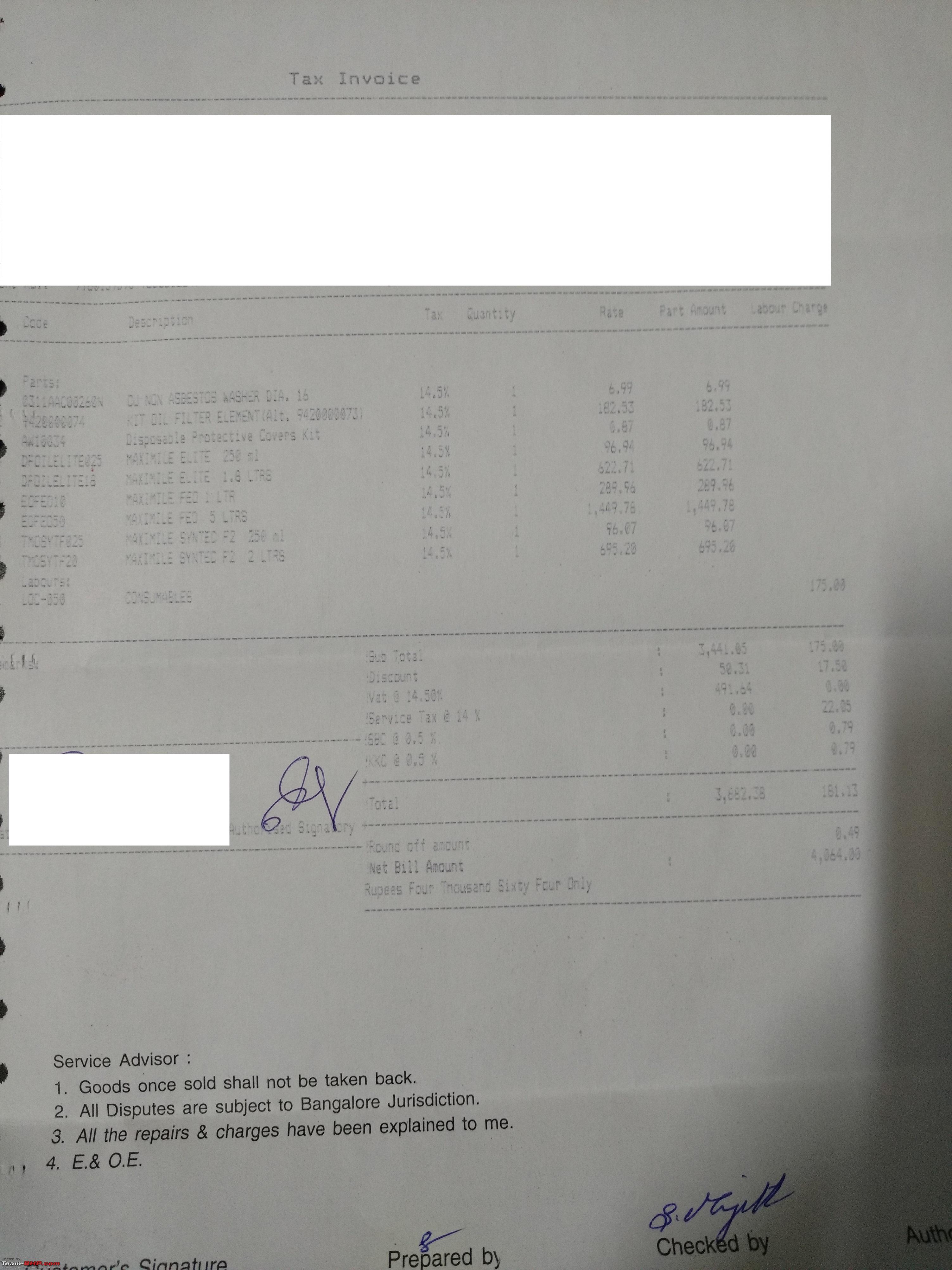

What was the total service cost and its break-up?
total service cost was 4K for replacement of oil filter, engine, transmission & differential oil along with some consumables. Bill attached for your reference. Apologies for the poor quality pic do click to view the full sized image.
Red Dwarf – My 2016 Mahindra TUV300 T8 Manual. EDIT: Now sold-serv2_bill.jpg
Do watch out for the AC cleaning & other usual additions. Tried to include 800 as AC cleaning and all I had to do is run my fingers along the AC vent fins and show the SA the thin film of dirt. He quietly asked the billing clerk to remove AC cleaning from the billable services.
