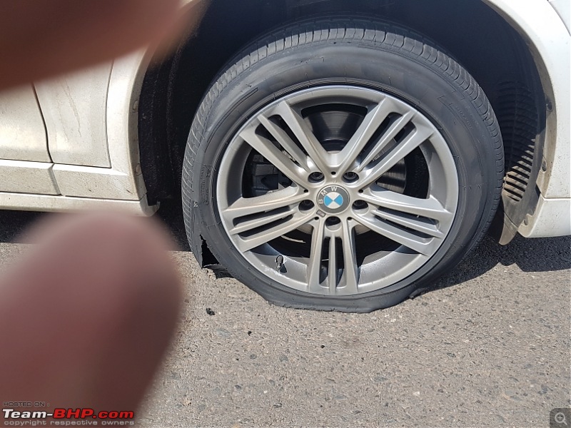

Tyre Failure
I have a disturbing update to share. I suffered a tyre failure on one of the new Pirelli Tubless tyres yesterday. Worst part is, it happened on the highway and at good speed.
We (Dad and me) had traveled to Belgaum as usual and planned to return on Saturday afternoon. I check tyre pressures religiously before starting off on any highway journney and this time too I checked all tyres with my trusty ol analogue gauge. I am maintaining 32 psi for city rides and 34 psi for highway. Load : 2 passengers and light luggage.
We left Belgaum at about 2 pm and by 2:40 pm or so were somewhere near Kittur (about 40kms on). The highway here is excellent. No potholes or cuts or the like. It wasn't very hot either. This section of highway has sections where the road is cemented and its a fast six lane section. At one point both of us heard an unusual "pop". Since it was unusual I slowed down a bit to see if I could notice something off. In hindsight, I should have pulled over and inspected. It wasn't loud enough for the two of us talk about. But later when I asked Dad he said he did hear the 'pop'. The road has these light reflectors and I though it was the sound of the tyres going over one of these. Since everything seemed normal and there wasn't anything unusual, I picked up speed and started driving normally. About 10 mins later all of a sudden I hear a load rubber roar followed by steering wobble. I lifted off the throttle and applied brakes slowly while drifting to the left lane at the same time wanting to pullover. I realised its the tyre and by the time I pulled over the tyre was gone. Sidewall had ripped with smoke coming out due to the heat. I was doing about 120 to 130 kph at the time . Luckily at this time there was no other vehicle around and I wasn't on an undivided road and I was able to steer the car to safety and didn't lose control. The incident has well and truly shaken me. Anything could have happened.
I think the 'pop' we heard was a sidewall bubble. It wasn't able to sustain the speed and load and gave way. Now why did it 'pop'? This is a fantastic road and I did not crash into any pothole or cut whatsoever. I had just about completed 50 kms of the 500km journey and checked pressures before starting off. I was barely warming up and picking up speed at this point and not that I had ripped the car for 100s of kms that caused the tyre to buckle. Can those reflectors cause tyre damage?
Maybe the tyre lost pressure due a puncture. Then again I have checked the tyre. There is no puncture or nail or foreign object on the tread. I am a very careful driver w.r.t tyres and there is no chance I scraped the sidewall on curbs etc.. to damage it. Why did it lose pressure? if at all we are guessing the sidewall pop was due to low pressure. Maybe it was just a case of tyre sidewall failure. The TPMS did not give any warning through all of this. I had reported before that the ABS based TPMS is not trustworthy.
Coming to the second half of the story. "Its a BMW, what are you going to do?" Luckily I had invested in a space saver + jack kit. This was a life saver. We were about 450 kms away from the nearest BMW service centre and without the kit we would have been stranded. We had the choice of returning to Belgaum, getting a tyre shipped from BLR and then return. Time cycle min. 3 days. Or proceed to BLR at max 80 kph for the next 450kms without any further tyre back up. I decided to proceed as I had fixed up some meetings in Bangalore for the coming week and the weather was clear in this part of the world. In hindsight, a mistake. I should have returned to Belgaum. Belgaum is my second home btw.
The usual 6hr journey took about 10 hrs and I reached BLR at 11:30 pm. Terrible weather on the way too. Rains in full force + water logging + night driving + driving on the puny space saver literally took the wind out of me. I was literally counting down every km praying that the space saver does not give up on me. Another puncture or something and I was gone. Cruise control was very very helpful. I set it for 78 kph and it did the rest. THis must be a record of sorts. 450 kms on the 125 section space saver in an X3.
Now coming to the replacement. I had recently switched to tubeless as I wanted a better ride. I've been driving on tubeless tyres for nearly 20 years and haven't faced any issues. This the first tyre failure I have suffered at highway speed and I am scared. I think RFTs are safer, but I've seen upteen no. of RFTs getting shredded like this on BMWs. I have two choices now. Go back to RFTs or get another tubeless of the same make and give it another go. I had replaced tyres just about 2 months back and have done not more than 1500 kms since. There were no adverse conditions for the tyre to go like this. Good road, tyre pressure checked, car not fully loaded, no apparent external puncture, relatively slow speed (I admit I drive quite fast on the highway), very new good branded tyre. Then why? I am sure the tyre company will wash off their hands.

Ouch, that hurts
Glad to see that you are safe. I would switch to RFT's for the pure safety aspect. If you do go for a new Pirelli, ensure the tread depth is less than 3mm different form the others else it will confuse the ESP, ABS etc in terms of power to wheel distribution and measuring speeds.

Sorry to hear about the failure of the new tyre. I also bought a 320d 6 months back and have retained the run flats. The main reason being the added safety it brings, especially when one is driving at high speeds. You were very lucky that you managed to keep things under control this time.
I would suggest changing back to the RFTs only for the added safety factor.( even at the cost of some ride comfort and lots of inconvenience.)

That's really scary! That is a sure shot case of sidewall failure. It appears that you might have gotten tyres from a bad batch or tyres that are really old. You might want to get rid of all those tyres to be safe.

That's a pretty scary incident. I am glad nothing bad happened. I almost replied to your last post about switching to non-RFTs but decided not to post it. Many forum members have posted in favour of switching to non-RFTs on this forum but it is not a good idea if the car is used for highway runs. Btw, this can happen with RFT also (I remember an old post by Turbonator having faced similar damage with an RFT).
Can you please post full tire spec (DOT code, date of mfg, especially load rating, etc.)?

Really scary and I think you and your dad dodged a bullet. A side wall failure at high speed is a worst case outcome. Personally, I think sticking to run flats makes sense - they are intrinsically safer than ordinary tubeless tyres.

Sorry to hear the incident but glad you are ok. Weren't those tires brand new? I am sure they would be under warranty. Hopefully just one bad tire was the cause. I think the you should file for a warranty claim. Such a expensive tire should not just give up under normal usage.

Santosh - That was a close shave, what are the load ratings on your tyres?

Sad. What about the rim? I hope there is no rim damage. Get the tyre replaced with a similar one and make peace with it.
