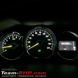

The picture with 6 digits on the 4WD’s ODO. 4 years and 4 months.
Two Renault Dusters that once shared a Garage @ 3,75,000 km-05ed876ee8b541feae7148fc269747d8.jpeg
Meanwhile, the white one needs a new pacemaker. Related post (ECM changed, now what?)
