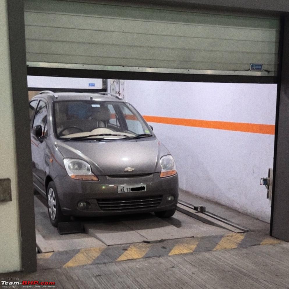

19,000 km Update
My 2012 Chevrolet Spark : A Comprehensive Review-front-view.jpg
I have been away from this thread for a very long time. Thanks partly to my signature procrastination and partly to the German Queen who shares garage with my Spark. Majority of the expenses incurred when it comes to the Spark have been more of wants than needs if one considers the fact that this is essentially a 9-year-old A-segment hatchback, not worth more than a 5-digit sum in the used car market.
I will list down everything that has happened in a chronological order since the commencement of my ownership around July, 2020. A scheduled service was carried out in December 2020, which included changing the oil, oil filter and air filter. Set me back a paltry 2700 bucks.

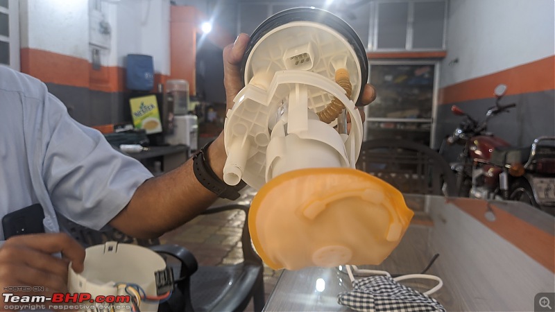

- Fuel pump assembly removed and dismantled. Fuel strainer found to be in very poor shape. Strainer changed. No improvement in performance
- Bought an aftermarket fuel pump motor and fitted it to the assembly. Issue seemed resolved for a week and returned again
- Finally, handed the car over to my FNG who changed the fuel pump feed pipe. This largely resolved the issue but the car still jerks when the fuel level goes anywhere close to reserve
I didn’t want to invest 4000 bucks for a brand-new fuel pump assembly, especially considering the fact that it still wouldn’t guarantee an effective solution. Vigsom’s advice from the beginning had been to maintain an adequate level in the tank and forget the issue. I decided to be better late than never when it came to this, and simply stopped allowing the fuel level to drop below 2-3 bars (around 5-6L).

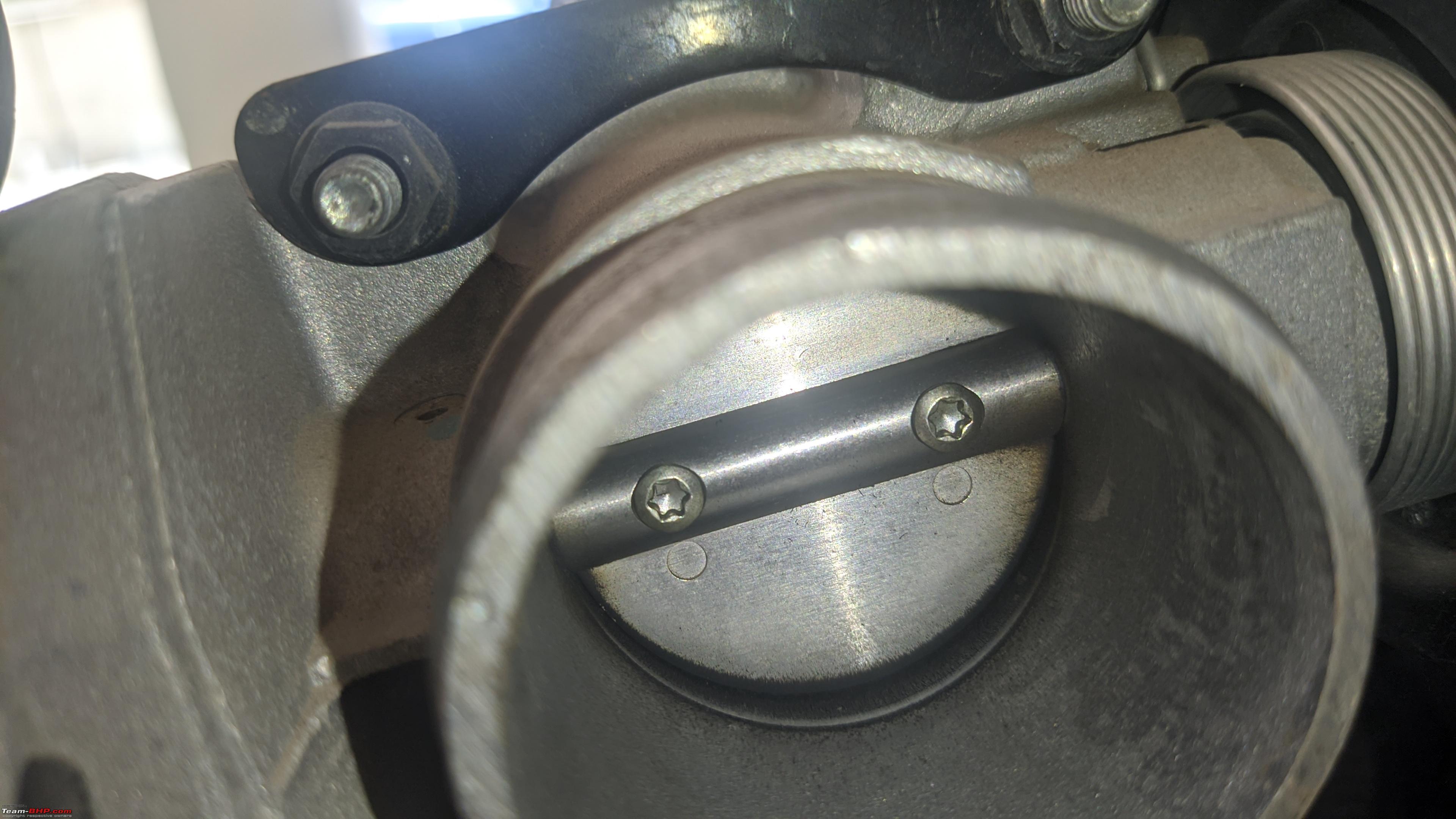

Throttle body cleaned by vigsom using IPA and a cloth. Quite a lot of carbon on the circumference of the flap. Overall performance did improve by about 7-10 percent I would say:
My 2012 Chevrolet Spark : A Comprehensive Review-throttle-body.jpg

The Old strainer. Reduced to a few pieces of fibre held together by some plastic. Had disintegrated completely otherwise:
My 2012 Chevrolet Spark : A Comprehensive Review-old-strainer.jpg

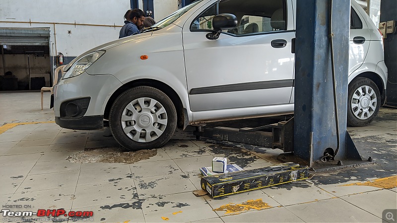

Finally, the new dampers went in. My FNG had advised me not to change them since there was no oil leakage observed. However, after my experience with the Jetta, where the dampers had nil oil leakage but very poor to no rebound, I decided to take what he was saying with a pinch of salt.
Needless to say, I was right. Here are the old dampers an hour after they were compressed. Zero rebound, although they seemed to resist compression well:
My 2012 Chevrolet Spark : A Comprehensive Review-img_20220210_145302.jpg
New Monroe Damper in place:
My 2012 Chevrolet Spark : A Comprehensive Review-img_20220210_140106.jpg
The FNG was very confident in pointing out that the car was "eating" tyres. He said the wear on the inner sides of both front tyres was uneven. After close inspection and 2-3 days of deliberation, I found these claims to be rubbish for the following reasons:
- The rear tyres (where the alignment is fixed and there's virtually no suspension ancillaries that can wear) had the exact same wear pattern.
- It had been barely 200-300km since I had the tyres changed. I don't think a car can eat through tyres this quickly even with poor alignment
- Most importantly, the car drove perfectly fine. Absolutely no issues with the way it went down the road. Tracked arrow straight with the steering at dead centre position. Handled perfectly. Stopped on a dime.
Additionally, 3 different mechanics at the same FNG had 3 different explanations for the "wear". One suspected it to be poor wheel alignment. I also called up the shop which changed these tyres and tried to have a word with the owner personally, but he was least interested in even listening to what I had to say. He bluntly asked me to depend on the FNG to solve the issue. If there's one thing I have realised about the work ethics in my city, it is the fact that nobody wants to take onus of their work and a word known as "customer retention" doesn't exist in their dictionary.
The second mechanic claimed it was a worn suspension. I had a thorough look at the suspension and yes, it isn't in the pink of its health. The ARB bushes do creak when they are cold. However, there's virtually no other issue with the front suspension that I could see. No unwanted play, no torn rubber bushes or bellows and no structural damage to the spindles or control arms.
The third mechanic said it was a steering rack issue. At this point, I decided not to even push for a resolution. I simply asked them to leave the car alone and that I would have a wheel alignment report generated and take a call.
My 2012 Chevrolet Spark : A Comprehensive Review-img_20220210_141204.jpg
My 2012 Chevrolet Spark : A Comprehensive Review-img_20220210_140159.jpg
The entire exercise including labour cost me around 7300 bucks. This includes the cost of the rear dampers. As a routine service, this would have ended up costing me around the 4K mark (used expensive synthetic oil). Reasonable I would say.
Coming to what I felt had changed in the car post servicing:
  • The ride quality has improved tremendously. I am so glad I ignored my FNG's advise and changed the rear dampers. The car used to crash through potholes and ruts before, but the ride has a very supple edge now. It rounds off potholes and bumps to perfection. There's a hint of stiffness to the ride, but in no way is it bone jarring or discomforting in the least. The rear end also behave a lot more predictably now during hard cornering or emergency braking maneuvers. In terms of the overall ride at low to moderate speeds, I feel the Spark is the best car in my garage. The Jetta is too stiff while the Kwid is too soft and bouncy.
  • The car feels a lot smoother overall. Yes, the jerks that were felt when the fuel level was low still exist, but the synthetic oil change has made the engine feel a lot more free revving and a tad smoother on cold starts. I personally feel its worth the price I paid, though someone who feels otherwise won't really be in the wrong either. It all boils down to how much you want to spend on the oil and what sort of drain intervals you practice.
