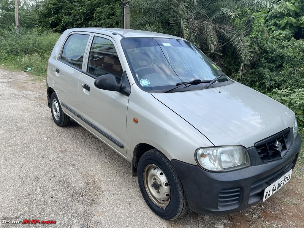

June 2023 - The Michelin Energy XM2 tyres from Dec 2012 and at 55514 kms on the odo had aged considerably and were well beyond their useful life. Maruti Suzuki Alto LXi Ownership Review : 17 years and 105,000 Km update-tw.jpeg
Sadly this size of tyre from Michelin is no longer available in India, else would have gone with the same set.
The Michelins were replaced at 98545 kms with a set of 5 MRF ZLX 145/80 R12 tyres along with WA, WB & tyre valves at Madhus Wilson Garden. I paid ₹15,260.
