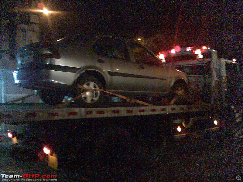

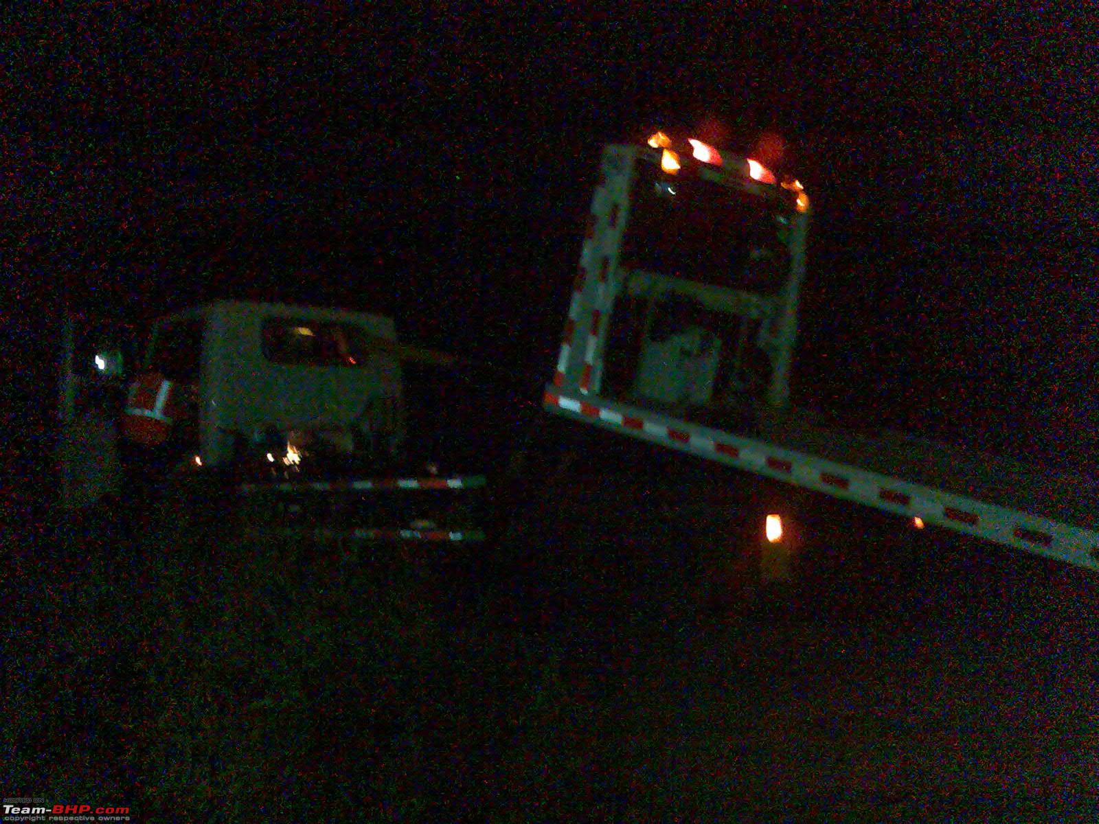

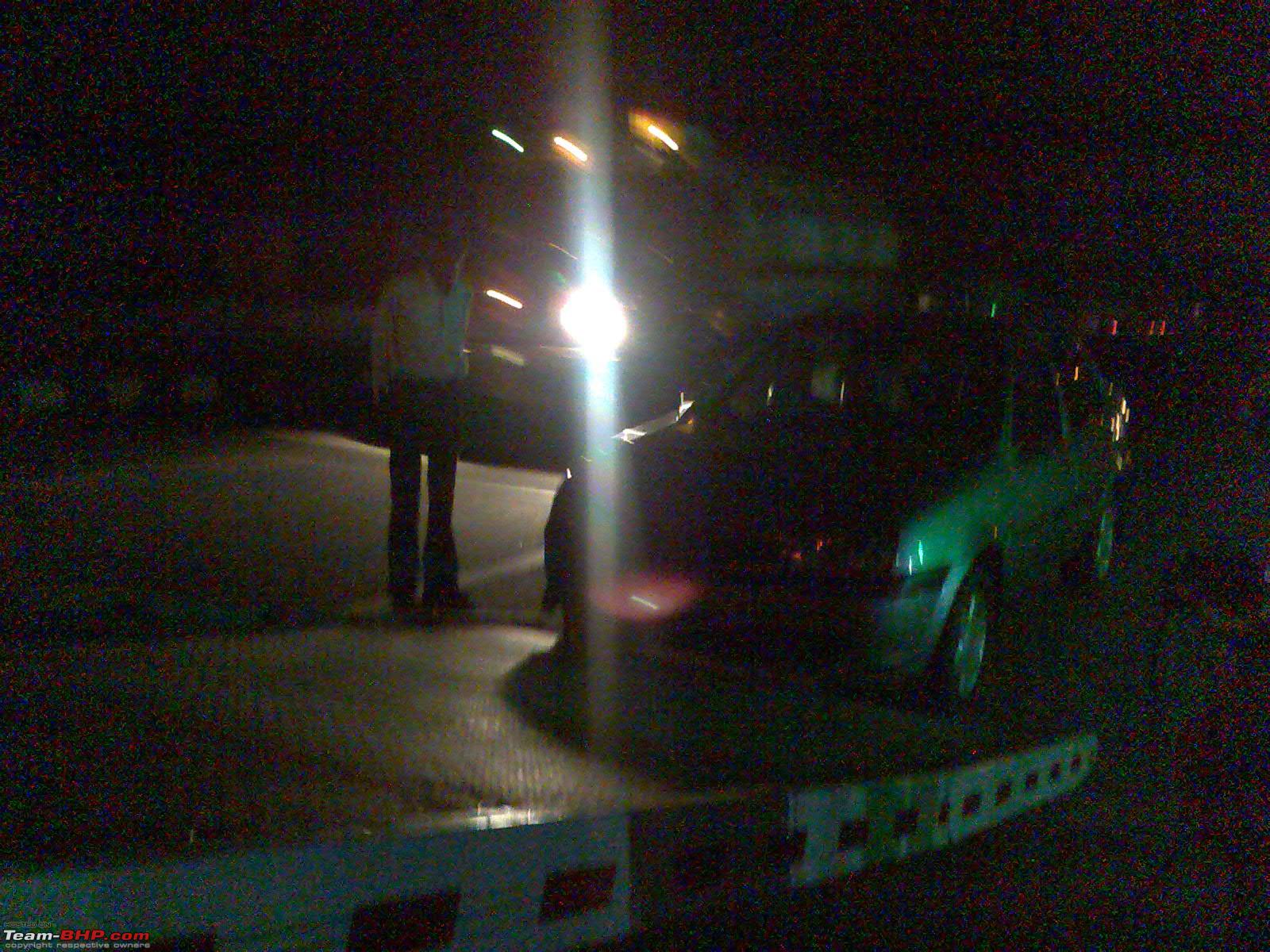

I was expecting an old battered nissan truck with a winch cable. But at around 9:30 the vehicle came. surprise
Three ppl got down and came and checked the car. They then offered water and soft tissues. The car was then loaded onto the truck. I was told to sit in the truck cabin. It was another surprise- neat bucket seats with a/c. Had a comfortable ride back to the service centre. The vehicle was dropped at the service centre. It was 1:00 by then. They then got me a cab. Till now everything went on fine. I was quite a happy man on the treatment meted out to me.
