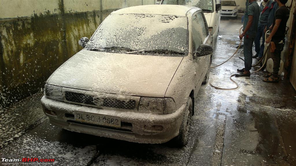

Hi, You see if you fill the brake fluid properly when you install brake pads then the brake fluid will go down low only when the brake pads near there lower limit .So the red light will still glow . Often people fill up the brake fluid even when brake pads are not changed or higher than maximum level .This is a mistake .
Getting the car washed earlier in the day.
ZEN : The Complete Review.-30082013033.jpg
ZEN : The Complete Review.-30082013034.jpg
ZEN : The Complete Review.-30082013035.jpg

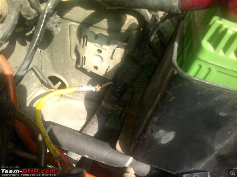

I faced a issue . The wire which comes from alternator to battery via a fuse link got burned at connector point. MASS said it is because over time connector got loose . Now issue is connector is i think 12 pin and lot of signal wires also use the same common shared connector. MASS says new connector is not there and you will have to buy complete wiring . For now i have used a 4 gauge wire to connect (burned down section) instead of connector and taped it all up and covered with a sleeve. However local electrican was saying over time this joint will become loose and it will heat due to which insulation will break down and you best bet is to open all wiring and replace the alternator wire in the OEM loom. Any suggestion on a solution to connect power wires using some tools , material .

I did google and found out that soldering a joint entirely will avoid heating of wire at point of joints . So got it done and hoping the solution is permanent.The yellow wire is the additional section i had to put in after the joint at coupler got burned . The hole in coupler is where the earlier wire used to rest .My electrician had to use a large soldering iron and we finished nearly a roll of solder wire trying to make sure we completely cover the joints . The joints i made was of handshake type and used three thin copper wires to tighten the joint before soldering .
ZEN : The Complete Review.-17102013136.jpg
ZEN : The Complete Review.-17102013137.jpg
ZEN : The Complete Review.-17102013138.jpg
ZEN : The Complete Review.-17102013141.jpg
ZEN : The Complete Review.-17102013140.jpg
ZEN : The Complete Review.-17102013139.jpg

Also i asked MASS about the burned Alternator wire at coupler point as in previous post and they said it is known issue in Zens and 800MPFI . They all get the coupler at same spot burned up as i got mine.
