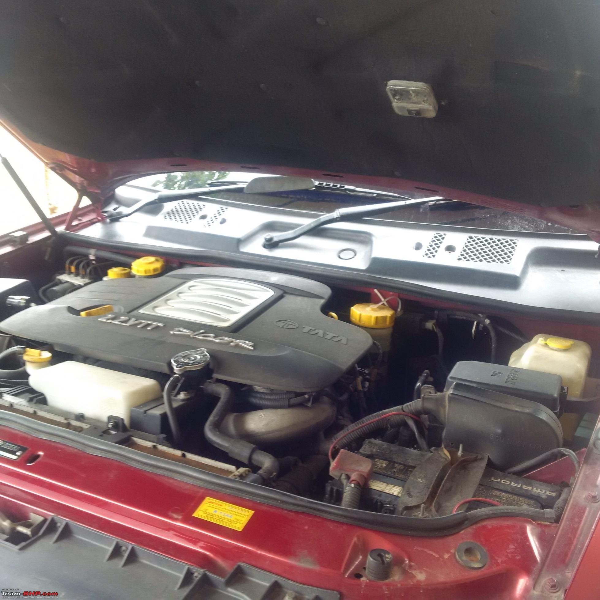

Currently ODO standing at 74,500 kms. Here for 5 days and got few things done, and also planning to.
1. Boot doors scrapping the body lead to the paint wearing off, leading to rust being formed. Sand papered it down and painted it myself. Not the perfect finish, but, serves the purpose.
2. Post the a/c work last time around, few cases of leaves being blown in from the a/c vent was noticed. Suspected the workshop guys to have fiddled with the previously shut air vent. Had time and decided to not only close the vent but also clean up the area.
This is what the activity was:
Removed the front cover; 5 screws and two wipers later, the end result:
(yes, tried to fix the lamp also; switch is faulty; not yet fixed).
Tata Safari GX 4x4 Mineral Red | 98,000 km and counting | EDIT: Sold-img_20141220_104505.jpg
Cleaned up the whole area. Vacuumed cleaned, hosed down and scrubbed where possible. Finally, blow dried.
Tata Safari GX 4x4 Mineral Red | 98,000 km and counting | EDIT: Sold-img_20141220_104523.jpg

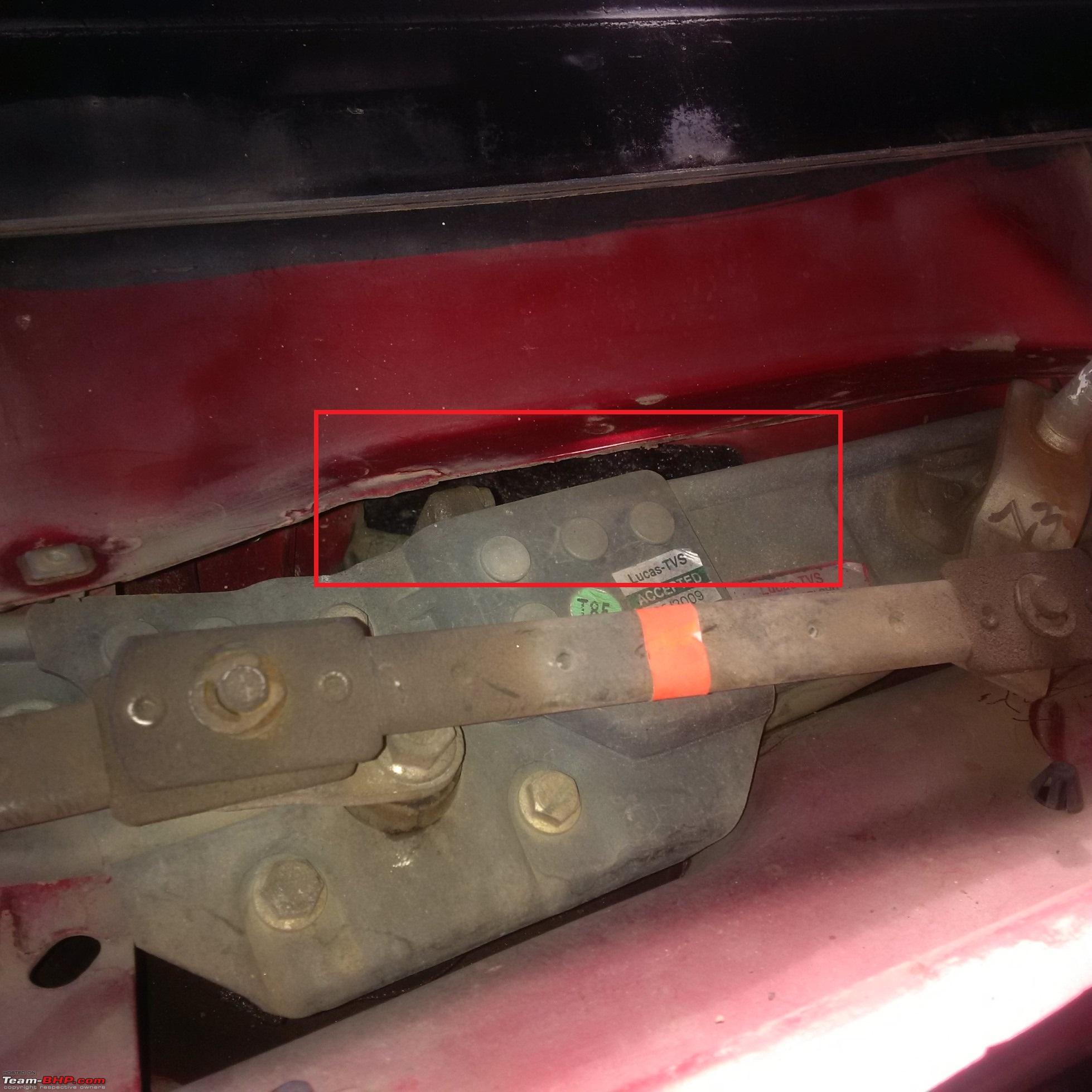

Noticed there are infact two vents for fresh air; the second one being behind the wiper unit. Can't do much about it. For reference:
Tata Safari GX 4x4 Mineral Red | 98,000 km and counting | EDIT: Sold-img_20141220_105629.jpg

3. The ABS light came back for an extended visit! Knew that it was one of the front ABS sensor playing havoc. This was there from day one and most recently, had one of the sensors replaced at a TASS. WD40 did the job. Sensor back online and working (tested).
4. With just ~5,000 kms from the last service, noticed that engine oil was at the minimum level. Not sure if TASS messed up during the last service or if there is an oil leak. Did not notice any oil marks at the vehicles usual parking spot. Plan to buy engine oil and top it up, as of now. Might take it to a TASS at Palakkad on 22nd to change the filter and refill.

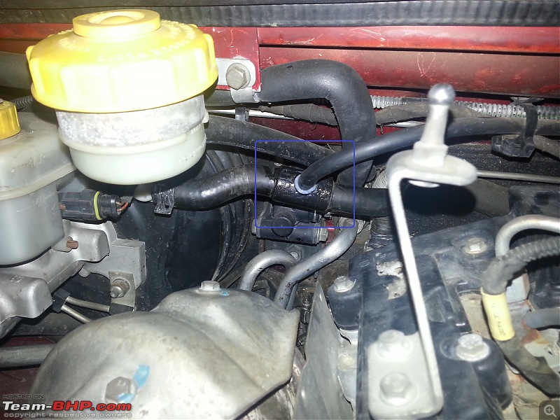

I had searched the forum for any leads and came across a post here about a new 2.2 that faced similar issue - service light on reaching around 90 kmph. The issue was traced to a faulty cracked plumbing hose. Asked the SA to check the plumbing before touching the turbo.
Now, with all the mumbo - jumbo that I did with the OBD scanner and TorquePro, they had realized that I wasn't the regular vehicle owner, due to which they took this suggestion seriously.
4pm got a call that it was in fact a hose that had a leak. This hose not only feeds the turbo but also the brake booster. Had had a case of brakes going hard without any action couple of days back. All due to this leak.

So, after getting close to 80,000 kms of running, went in for a change in the tyres. It was cutting it too close as the tyres not only have crossed 6 years of service, but also few cracks started developing.
With the good experience with the Michelin's, decided to go in for the same make and model.
Prices were being quote at INR 8,100, with the lowest being INR 7,600, at Trichy and Chennai.
Fortunately had a member in the family working for Michelin and was able to get a good discount, which end with each tyre costing INR 6,100. Sweet!
