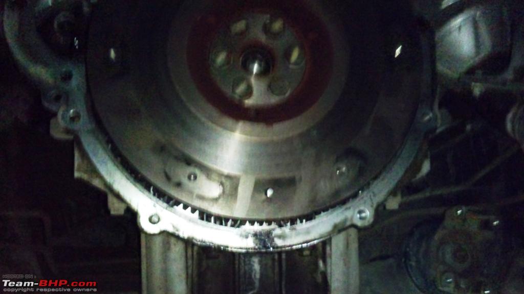

Bell housing & gearbox down
Hawk-On-Fours® (H-4®) with a tail - Scorpio mHawk 4WD EDIT: Sold!-3333.jpg
Oil marks
Hawk-On-Fours® (H-4®) with a tail - Scorpio mHawk 4WD EDIT: Sold!-2222.jpg
Oil-soaked clutch (friction) plate
Hawk-On-Fours® (H-4®) with a tail - Scorpio mHawk 4WD EDIT: Sold!-1111.jpg
Adequate material still remaining on friction plate after 68.5k km
Hawk-On-Fours® (H-4®) with a tail - Scorpio mHawk 4WD EDIT: Sold!-4444.jpg

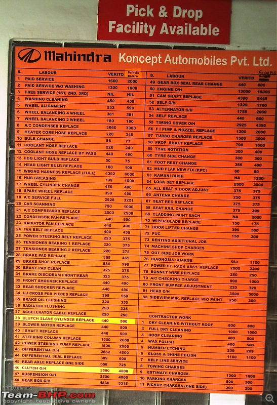

It was found that the clutch slave cylinder (CSC) had leaked, and the clutch friction plate was soaked with hydraulic oil, requiring replacement of both these parts. This is just 28000 km after the CSC was earlier replaced under warranty in May 2011. Since M&M is well aware that this is an unusually highly failure-prone component, the issue should have been taken care of even under extended warranty. However, Koncept refused to honour warranty, and I was forced to pay for both parts, whereas, as per terms of the EW (i.e. all internal oil seals of transmission and gearbox are included and covered under EW), the slave cylinder leakage should have been acknowledged as an internal oil seal failure and replaced free of cost (the friction plate being damaged due to oil leakage, a partial cost should have been recovered from me).
In addition, Koncept unfairly charged me Rs.4000 plus taxes as labour charge for the job done, whereas the labour charges list displayed outside the service centre mentions the cost of CSC replacement for Scorpios, Xylos and Boleros to be Rs.500 (see pic - item no. 38, highlighted). On the other hand, a complete clutch overhaul (item no. 46 on the pic, highlighted) is understood to mean that repairs would be also carried out to clutch components such as the master cylinder, hydraulic lines, replacement of pressure plate and flywheel + ring gear etc. - none of these parts were opened or required repairing on my vehicle. In my opinion, this is downright cheating.
