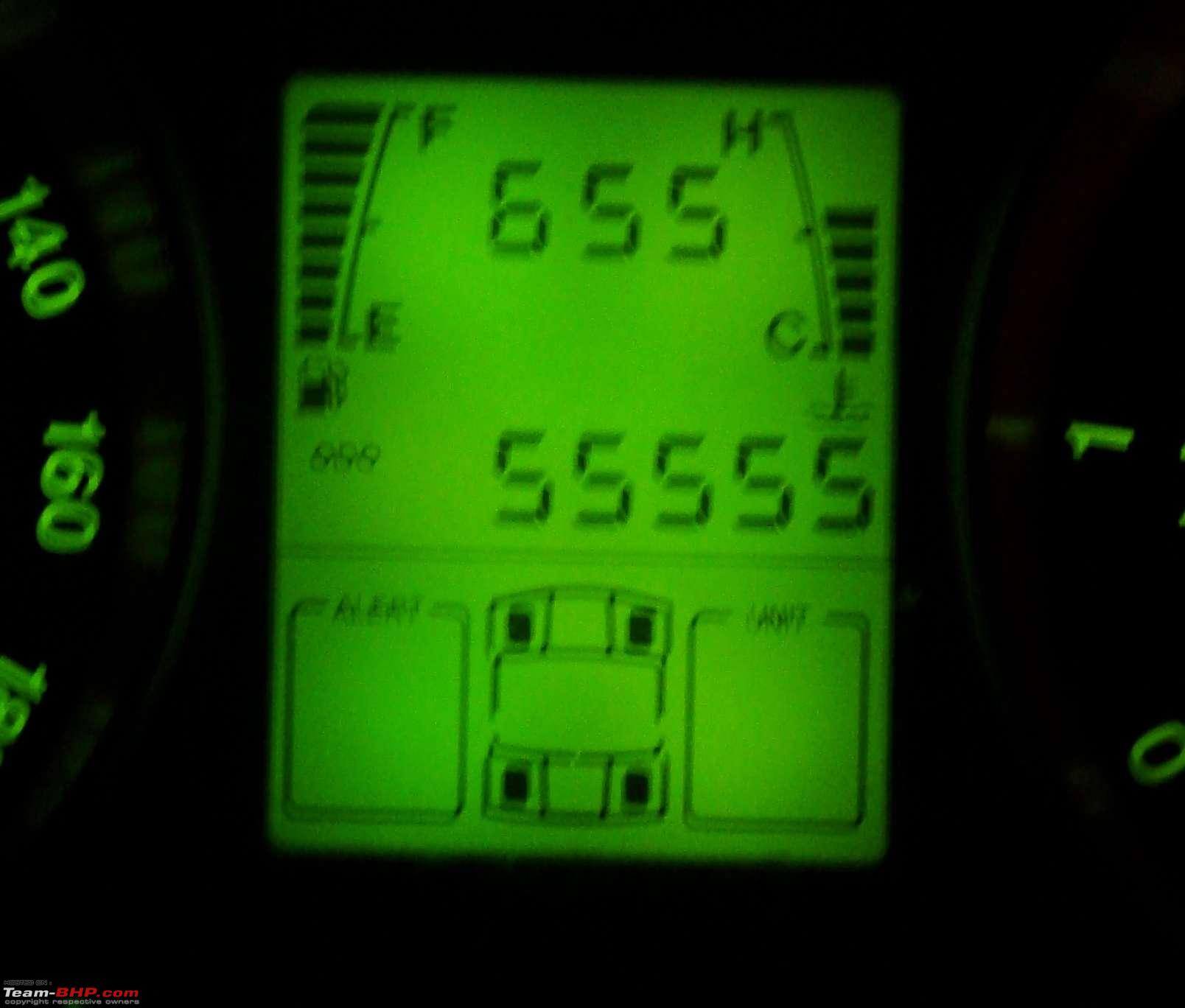

Interesting odo reading came up on 30 Dec 2011.
